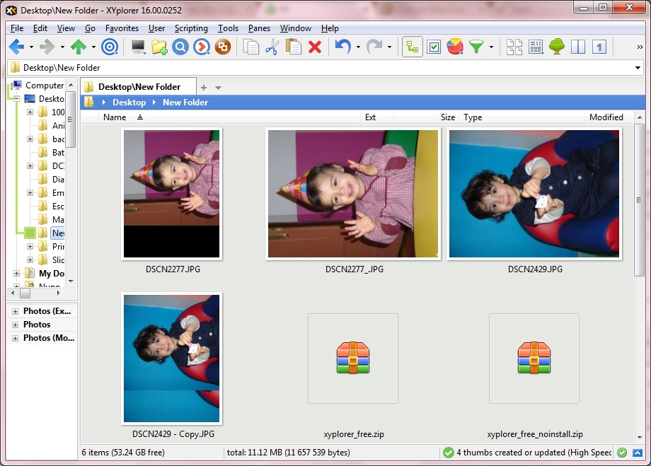

3. Result: the thumbnail of the original picture shows up sideways, as expected, but the thumbnail of the modified picture, which has the correct orientation EXIF flag set, shows somewhat distorted (the frame is rotated, with the right aspect ratio, but the picture inside is not rotated and "corrupted")
I hope you have the time and are able to reproduce the problem using this kind of setup.

I was hoping that a clean XYplorer install running inside a clean standard VM would help identify/isolate the problem I'm having...admin wrote:Tried with fresh version: no problems here.
I'm including an attachment of a screenshot of the XYplorer window, so that you can be sure I'm not seeing things...
(This was obtained from the latest beta of XYplorer I have installed, but inside the VM, as I mentioned before, the end result is exactly the same.)
