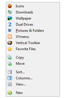

In using a script like this I've found out in short order that since you loose your normal right click default menu, you may at times miss the "new folder" or "copy to" type menus. What I've done to solve that issue is made a personalized menu of add-on menus that I add to the default or one or more of the file-type specific menus as well.
First do yourself a favor and utilize the User - Manage User Defined commands and make up your specialized "copy to" or "move to" menus of folders to which you frequently copy/move files. I never took advantage of this nice feature. It will make up quick and dirty menu of folders to copy/move/backup files. Each folder you input will end up having its own Command ID that you can use, but more importantly the menu of multiple folders can be raised through a command ID. Yes, it's all in the help file, but this ends up working quite well this script (WhiteSpaceCtxMenu).
#4	User | Move To | - submenu -
#5	User | Copy To | - submenu -
you may also miss having the Sort / Column / View menus which can be easily solved as well.
/*** Copy/Move menu ***/
   $CopyMove = <<<COMO
"Copy|:copyto" #5;
"Move|:moveto" #4;
"Sort...|:sort" #320;
"Columns...|D:\Graphics\Icons\table-select-column-fatcow.ico" #360;
"View...|:viewthumbs" #301;
"New|:newfolder" #230;
COMO;
This menu can be easily added to any of the other menus you've devised by a load line like this...
if(gettokenindex("<curext>", "jpg|gif|png|ico", '|', 'i')) {load "$image;<crlf>-<crlf>$CopyMove", ,s; end(1)}   //load image and CopyMove menus together
Unfortunately though you can not simply add a menu like this to Favorite Folders or Favorite File by combining the CID for FF to $CopyMove variable. If you'd like to extract the favorites to use them in a menu which is combined with another, you'd have to do something along these lines...(unless someone knows a way around this?)
  $FavFolderCount = getkey("Count", "Favorites");
   if($FavFolderCount == "0") {$FFs = "No favorite folders";}
    else {
      $FFs = "";
      $i = 1;
    while ($i <= $FavFolderCount) {
       $a = getkey("Fav$i", "Favorites");
       $FFs = $FFs . $a . "<crlf>";
       $i++;
    $FavFolders = trim($FFs, "<crlf>", 'R');
And then your load line would be something like this...
load "$FavFolders;<crlf>-<crlf>$CopyMove", ,s; end(1)
...and the default menu or any other menu result something like this...
I'll update the first post to include the above. Thanks.
