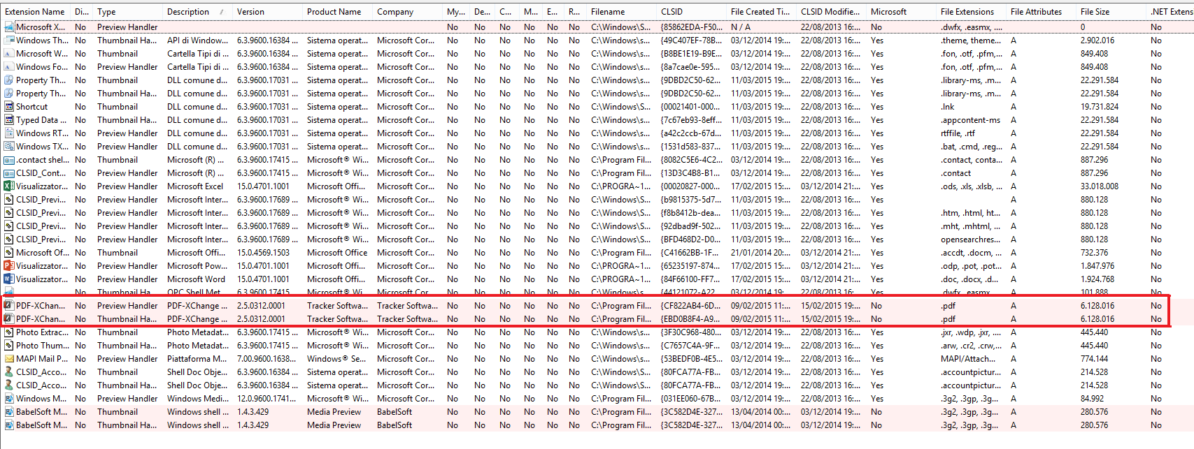

PDF Xchange Editor installs both 32 and 64 bit shell extensions, so it shouldn't be too difficult to fix.

Ok, then try the Editor. You can see with ShellExView (http://www.nirsoft.net/utils/shexview.html) that the 32 bit extension is installed (Options > Show 32 bit etc.). It should be trivial for you, from there, figuring out what's the culprit and finally get pdf thumbs.
