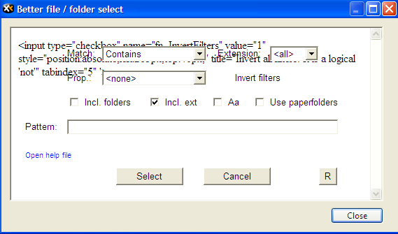

@Ken
Can't reproduce... Try v0.8 when I post it in a few minutes, please. If you have the same behavior, show a screenshot of your settings in the html dialog and a few item names which with it doesn't work.

Thanks for allowing ::multiple::patterns. Took me a moment to figure out how to restrict it to extensions only (DOS expression). An additional drop-down option "Extensions only" would spare the repeated typing of "*." but it's no big deal.
What does Match: Random do? And how do I get "every nth item" to work?
