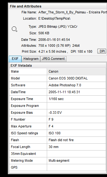

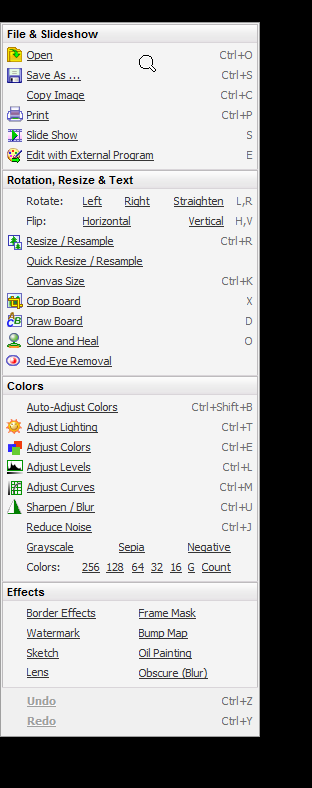

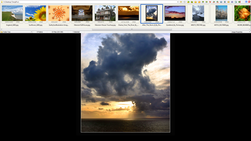

It may sound funny but I... use them all. So XNViewerMP is my primary viewer for folders with pictures. I really like it because of how fast it process many images and how well it displays them then in thumbnail view. So I always use it when I need to view many many images and as good as possible. The way I use XYplorer is a bit more complicated. I have paper folders where my "favorite" pictures are located in. So when using XYplorer, this is the primary use of it and also for folders with less amount of files. While browsing pictures in XYplorer, if there's an image I want to have a bigger look at, I have JpegView as my primary image viewer that's associated through PFA. I actually also have several backup image viewers set up in PFA and that is FastStone Viewer (since it has very easy to use crop and resize functions) and HoneyView(mainly there because it has the capability to browse images within archives). There's also ImageEye but it's not setup in PFA at all and simply located in the same folder as my other image viewers. I do use XYplorer's built in preview too but it's not used as a large picture viewer but more of a "mini" viewer that's usually set to be twice or three times the size of the my current thumbnail size.
Actually, I also have FastStone Viewer as an alternative to XnViewMP and it was my main one for a very long time and that's because it has one of the best full screen capabilities and it still is. You can view pictures in full screen and by simply moving your mouse to the top of the screen, you also get a very nice scroll horizontal scroll window with large thumbnails and quickly select pictures to show in full screen is just plainly excellent. Nothing can come close to this so far from any apps I have tried. Unfortunately I have pictures that have diacritics or use Unicode and that's where FastStone has issues. It's not fully Unicode so certain things show up fine but other things do not. Here are some pictures of it. You hover your mouse at the top and you get that thumbnail view to quickly select the next picture for full screen viewing. You hover to the left and you get an edit pane. Hover to the right and you get an info pane. Hmm... perhaps Don should make something like this in full screen view?
2014-07-30 20_39_38-.png (22.77 KiB) Viewed 5045 times
2014-07-30 20_39_48-.png (16.46 KiB) Viewed 5045 times
Yeah it's over complicating things but I it that way for my usage.
EDIT: Interestingly enough, after talking about FastStone Viewer's full screen feature, apparently XnViewMP had it implemented. It wasn't there in the original XnView. Guess someone liked it!

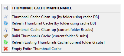

Version 1.02 - updated script. I think it's a more complete thumbnail maintenance script now.
1. Script was a little slow to display the menu since I had it doing a significant amount of work in the thumbnail cache database prior to screen display. Instead of doing this cache info gathering work in "_Initialize", I changed the script to do it in a sub after menu display.
2. I made 3 new options that are based on your current folder location as opposed to the thumbnail database files though it will update the DB files as appropriate.
   a. "Thumbnail Cache Clean-up [current folder & subs]" - This will essentially delete all the thumbnail cache from the current folder and all its subs and update the DB by comparing all the folders with those in the thumbnail cache.
   b. "Build Thumbnails Cache [current folder & subs]" - This menu item will build a new data base of thumbs for the current folder and all its subs. It makes no difference if there were some folders which had pre-existing cache or not. It will (actually in this case it's XYplorer itself is doing the work) either write new thumbnail cache or write over ones (i.e., "dat2" and "dbit" files ) that already existed in the XY thumbnail folder.
   c. "Refresh Existing Thumbnails Cache [current folder & subs]" - The last new menu item will do the same thing as the option above, build a thumbnail cache for the current folder and all its subs, but in this case it will only re-build the cache for the folders that already have thumbnail cache. So it's not making any new ones for any of those folders that didn't have a cache, only rebuilding the cache for the folders that had one. I think this option is very handy to keep the database trim. Remember thumbs will will stay in the DB when you move, delete and rename images so if you've done a lot of that, it may be much larger than it needs to be.
Note if you select a folder which has many sub directories below it, it will take some time obviously to generate the new cache for each of those folders. Let it do it's work. You will get a message in the status bar that it's has been completed. Certainly don't be in the root of C:\.
Thanks Stef123 for making me realize that an option based on the current folder would be a good idea.

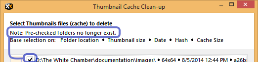

I just noticed it pre-selects non-existant folders during cleanup — a nice surprise!

klownboy wrote:I'm not sure I follow you on this comment..."pre-selects non-existent folders".
I was talking about the cleanup inputselect.
