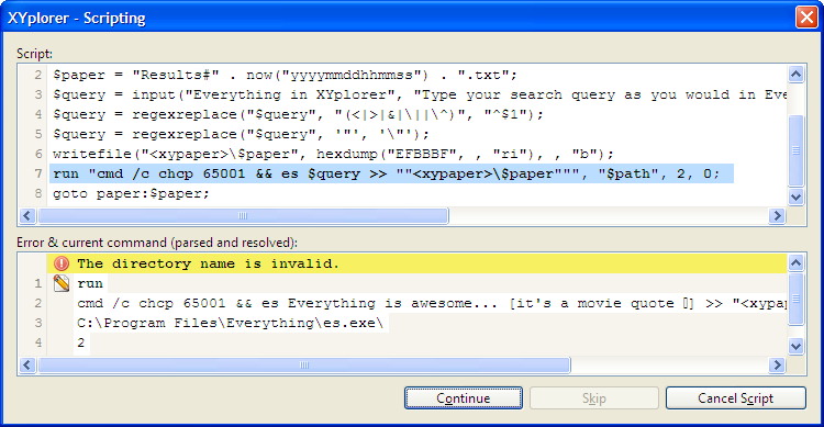

yusef88
- Posts: 1148
- Joined: 28 Jan 2013 03:50
Re: [Coming soon] Everything in XYplorer — Rev. 1.00 / 2014/
doesn't work?
$path = "C:\Program Files\Everything\es.exe\";To see the attached files, you need to log into the forum.
Marco
- Posts: 2354
- Joined: 27 Jun 2011 15:20
Path should be
Moreover, are you using at least 14.20.0305? I haven't tested on XP and can't do so, there could be the remote chance that chcp 65001 doesn't work on XP.
$path = "C:\Program Files\Everything\";Tag Backup - SimpleUpdater - XYplorer Messenger - The Unofficial XYplorer Archive - Everything in XYplorer

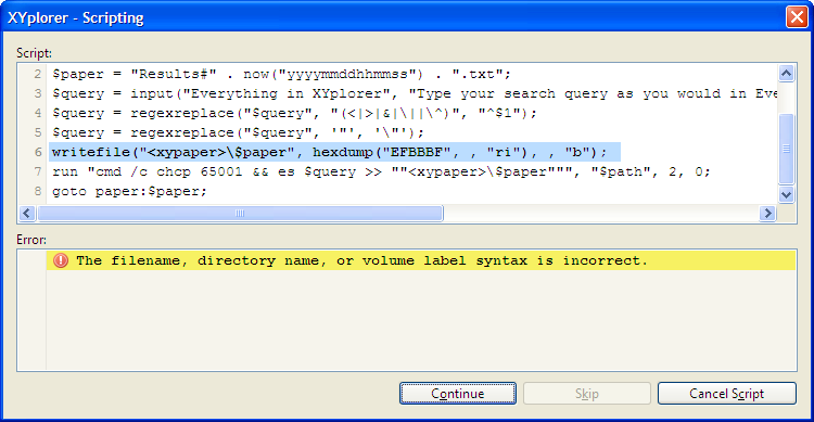

Marco
- Posts: 2354
@binocular222: both 1200 and 1201 appear to be invalid codepages here, so I have to stick to 65001/utf8
@Don: I share the same doubt.
I just took a closer look at those screenshots: the problem seems to be at line 6, where the variable <xypaper> isn't expanded. Weird...
