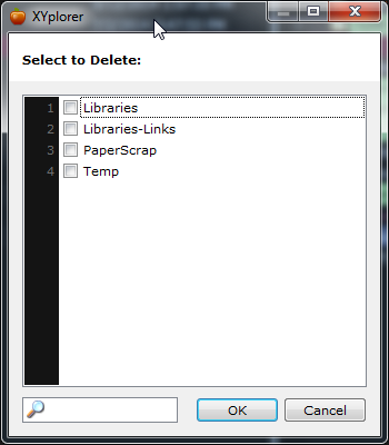

Enternal
- Posts: 1175
- Joined: 10 Jan 2012 18:26
Re: Laycat: simple picker for layouts and catalogs
Yeah I think it might be better to be separate since it's not really related to layouts anyway. Anyway, fixed a couple more things, add ability to delete Paper Folders directly without navigating to the folder!, use a different method that was recently fixed by Don, and some other things I forgot. Kind of fun messing with it actually. Had an issue with heredoc not taking "<crlf>" as a literal even when I was using single quotations. Wonder how I can get that to work.klownboy wrote:@Enternal, yes, that is cool. I'm tempted to build it into the LatCatTool menu so they're all together, but possibly it would make it too long especially for smaller displays when someone has a bunch of menu items.![]()
Thanks,
Ken
$Savemen = <<<SAV
"Toggle Paper Folder|:paper" #778;
"Delete Paper Folder|:del" InputSelect("Paper Folder".'<crlf>'."Select to Delete:", "$PapersFile");
SAV;
$MScript = $Savemen;
Load($Savemen, , s);To see the attached files, you need to log into the forum.
