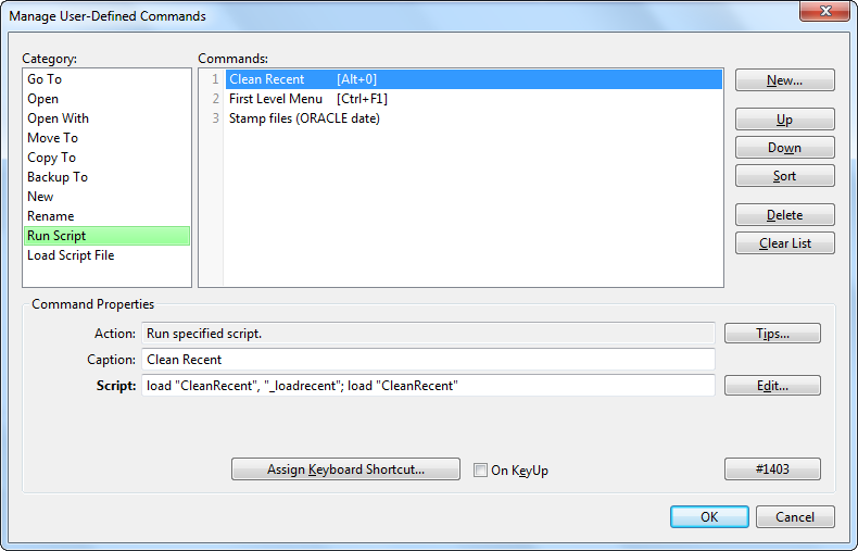

There is no need to change that line. It is just interesting, showing the power of regexp. But to solve the keyboard issue, this can be a solution for you, as you prefer the letters to access the drives rather than the options:
CleanRecent.xys
(2.22 KiB) Downloaded 344 times
Ah, and the shortcut to the menu. Use the User/Manage commands menu, and create a new item, which looks like this (my hotkey is Alt+0):
Other solution can be to emulate the left click on your Clean Recent user button. In this case you should write this into the Script field:
button "ctb20"
where you should change the number behind "ctb" to the number of your user button, which is assigned to the Clean Recent. (Mine is 20 as you can see.)

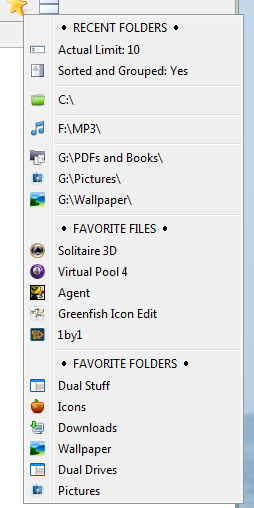

Hi, I really hope you don't mind LittleBiG, but I toyed with the CleanRecent script a little. It is excellent by itself as I mentioned earlier, but I thought why not combine it with both Favorite Files and Favorite Folders to get an even more useful script that should look something like this...
Recent Folders.PNG (32.74 KiB) Viewed 6649 times
The only difficult part for me anyway was to single out any Favorite Folders which were Dual type displays. If you have any issues with the menu displaying the "bell" character shown above (made by pressing/holding alt and punching 007 on the numpad), substitute something else or delete it. Obviously, it works best and looks better if you have at least a few Favorite Folders and Favorite Files. You can check or make some in Tools | List Management. And no, the ones shown are not my favorites but I added them to see if this works.
