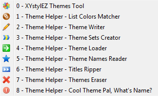

So here it is: XYstylEZ Themes Tool, v1.
Also, I am sharing (currently) EIGHT tools to ease the process of themes creation/management/publishing.
Some I used to build the core product, some were suggested by users, some were thought out as additional
features/aids. They are concatenated into a single .xys as my suggestion for usage is: have a CTB
(Custom Toolbar Icon) filled with the Theme Set I published on first post, under left click, and this
attachment (XYstylEZThemesTool_PlusHelpers_v1.zip) configured as right click.

The Tools:
Designed (but not limited to*) for aidinng XY Themes creation and management.
XYstylEZ_ThemesTool aka 'main script' - Tools, Configuration, Colors|Styles - create your theme there,
*save your configuration*, then run the tool. All the process is guided, yet simple.
XYstylEZ_ThemeHelper_CoolThemePalWhatName (suggested by user aurumdigitus - sorry, this is the best I could do!)
- well. It tells you the name of the current theme.
XYstylEZ_ThemeHelper_ListColorsMatcher - ever wanted a way to make other options match list, easily? Me, too.

Here they are - XYstylEZ Themes Tool, plus Helpers.
The Themes Tool ('main script') is essentially a settings export script which also provides some (auto-) backup functions
of the involved configs, caring also about XY ini itself. It creates a Theme containing your current colors
config, plus other minor style-related settings which not only is dependencies-free but also has got
settings-protection functions, too. Cool, huh?

...use the Themes Tool:
1. customize XYplorer interface to your liking using Tools, Configuration, Colors|Styles. Then, SAVE YOUR SETTINGS!
(this is important, otherwise the tool won't 'see' what you've done. 'Save Settings' or 'Settings Special /
Save Configuration' under 'File' at XYplorer interface).
2. Execute the script contained in the attached 'XYstylEZThemesTool_PlusHelpers_v1_1.zip' file. Even if you open the
zipped 'XYstylEZ.xys' with notepad, copying the whole content then pasting it under 'Scripting > Run Script...' and
clicking 'ok' will do.
3. Enter a name for your theme. If you click 'ok' on the next 3 dialogs you'll skip more advanced options, but you've
got what you want. The confirmation box offers a way to immediately create a FILE theme (attention: 'cancel' is
the default button, here!, and it will just skip creating the file internally) - the Theme will be on clipboard,
ready to be used or pasted elsewhere.
4. Done! ^^
...use the Helper Tools:
They're easy ride aside having very simple tips to guide your usage. Just relax.
Regarding those Helper Tools, they were designed (but not limited to*) for aiding XY Themes creation and management.
List Colors Matcher - ever wanted a way to make other options match list, easily? Me, too.
Theme Writer - aids for theme creation sessions (Themes Tool has got this covered, but
may happen someone prefers doing this externally - who knows...).
Theme Sets Creator - merges all themes you created in the order you wish, getting them
ready for publishing.
Theme Loader - in case you don't use a full theme set and prefer a 'select a theme inside a folder' approach.
Theme Names Reader - presents internal vs. external names of the themes.
Titles Ripper - 4 ways-at-once to strip names out of Theme Set files.
Themes Eraser (suggested by user aurumdigitus) - get rid of nasty themes on Theme Sets,
the easy way.
Cool Theme Pal, What's Name? (suggested by user aurumdigitus) - well. It tells you the name of the current theme.
