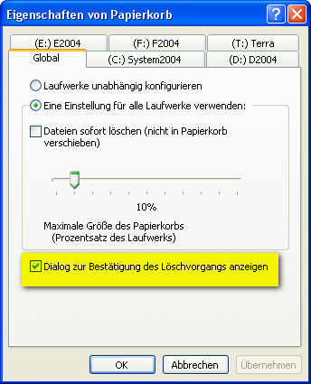

Found out that even Windows itself falls into the same trap! If you untick this box in Recycle Bin properties (tested under XP) ...
... then all works as expected on a drive with recycle bin. But e.g. on a USB drive the deleted files go to permanent hell without any prompt! Wow. :shock:
ADD: Tested under Win7... same story! And I bet it's also the same under Win8 (where, as I just read*, the confirmation is turned OFF by factory default!)... this is insane.
* http://www.askvg.com/windows-8-recycle- ... te-a-file/
BTW, unfortunately the Windows Recycle Bin settings overwrites the settings in XYplorer here, so when the dialog is turned off in Windows then XY *cannot* show it! Windows will ignore the flags! I will now try if I can find out about the Windows settings and then show an XY native confirmation dialog in case it's turned off under Windows. This problem will be major issue in future when Win8 gets more users. And by a weird conincidence, 10 minutes ago I got an email by a new Win8 user having exactly this problem!!! Wow.

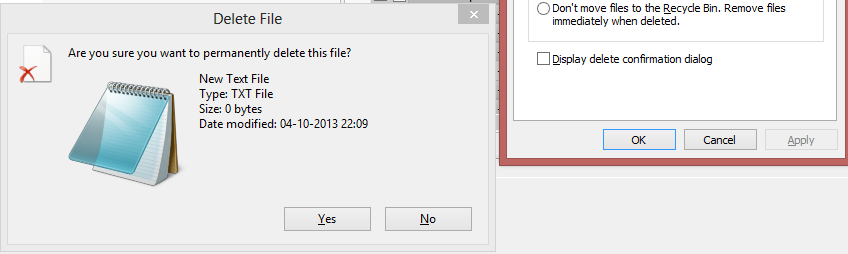

by nerdweed
I am on Windows 8. The delete confirmation was off on my D drive. And both the delete and shift delete - XY was able to control it completely.
Whereas Windows Explorer didn't show the confirmation for either.
