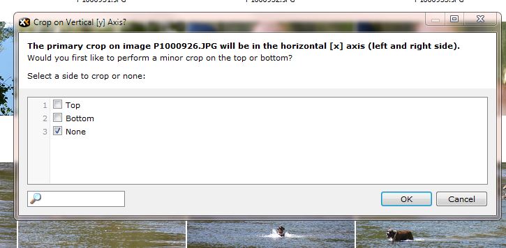

Why not use inputselect in lieu of input for the "Save Session as..." dialog box and have a check box for "Save Session with layout" and another with, "Save Session without layout". I've use inputselect a number of number of times to provide a checkbox selection and it works great. You can provide a default pre-checked selection which in your case would probably be "Save Session without layout".
       $crop2 = inputselect("The primary crop on image ". $fn ." will be in the horizontal [x] axis (left and right side).<crlf>Would you first like to perform a minor crop on the top or bottom?<crlf><crlf>Select a side to crop or none:","Top|Bottom|+None", | ,2, "None",700, 300, "Crop on Vertical [y] Axis?");
       if ($crop2 != "None") {sub "_crop2_y"}

klownboy wrote:Why not use inputselect in lieu of input for the "Save Session as..." dialog box
Nice idea, and I'm well aware of inputselect(), but then... where do you enter the name of the session? :biggrin:
(unless you were talking about opening a second dialog, but I guess not.)
