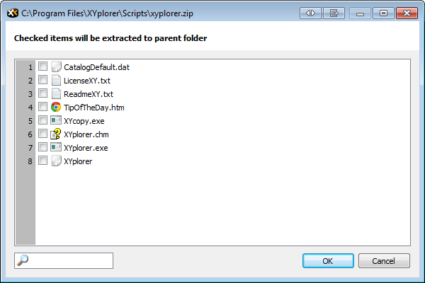

Thanks for adding scripting commands.
Few thoughts:
1. Can contents of zip_list() show extensions by default like name.ext rather than just name?
2. Is it possible for command zip_extract to extract specific files? syntax: zip_extract(zipfile, path, files to extract)
3. Can command zip_extract have a smart mode for extract here, where if top folder is folder then use extract here, else use extract to folder\ ?
I am trying to achieve the following with the below code (which does not work yet but try selecting a zip file and run it from address bar):
$extract=inputselect ("Checked items will be extracted to parent folder", zip_list(,"|",1),"|",3,,,,"<curitem>"); text $extract;b. Extract checked files to parent folder, hence request for #2.
UPDATE: Just realized #1 will not help me to get real icons since they are inside the archive, right?

It does not show the extensions??? Certainly does here.serendipity wrote:1. Can contents of zip_list() show extensions by default like name.ext rather than just name?

Re: ZIP Support (so I can finally retire "PowerDersk Pro")
Interestingly some show, some don't.admin wrote:It does not show the extensions??? Certainly does here.serendipity wrote:1. Can contents of zip_list() show extensions by default like name.ext rather than just name?
Freakish. This is not supposed to happen.serendipity wrote:Interestingly some show, some don't.admin wrote:It does not show the extensions??? Certainly does here.serendipity wrote:1. Can contents of zip_list() show extensions by default like name.ext rather than just name?
Yes, here's another from another PC: Much better, only the last one, XYplorer.url is missing.admin wrote:Freakish. This is not supposed to happen.serendipity wrote:Interestingly some show, some don't.admin wrote:It does not show the extensions??? Certainly does here.serendipity wrote:1. Can contents of zip_list() show extensions by default like name.ext rather than just name?
