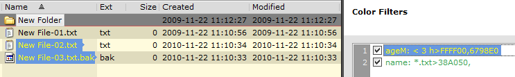

Don, did I miss something or have you not implemented any variation of the "continue" switch, yet?
I thought it was:
Further, it seems to me that the autosize columns is a little too aggressive when combined with the color filter background and little filter type marker. As you can see in the above screen shot it's a bit cramped at the end of "New File-03.txt.bak" and distracting how busy that's become. It looks much better if I use View->Columns->Grow Name Column, but that's forgotten when combined with the Autosize Columns List setting.
It would be nice if one of the following was in place:
And to share, I've added the following filters to the top of my list to create a bit of a "freshness" feature. It allows me to spot files modified in the last week and the darker the background the more recent the modifications:Looks like:
I thought it was:
And was disappointed it was Details mode only, but then realized that's not the case. However, this seems to be broken here (also on a fresh copy):Or am I mistaken in how this is to work?Code: Select all
v9.70.0038 - 2010-11-19 20:36 + Configuration | Color Filters: Now, in Details mode, the first matching filter *with* backcolor (if any) is displayed combined with the first matching filter *without* backcolor (if any). For example, if you have these filters defined and activated (copied from List Management to show the colors): ageM: < 3 h>FFFF00,6798E0 name: *.txt>38A050, then every TXT file that's younger than 3 hours is displayed with the Name column colored "FFFF00,6798E0" (Text, Background) and all the other columns colored "38A050" (Text only). Yeah!
- A little extra padding was applied internally when autosizing.
- The use of Grow/Shrink Name column was more of a "global" action that was reused & applied when autosizing.
- There was an INI tweak for the user to add a few more pixels to the minimum width.
+ageM: < 1 h>,006000
+ageM: < 6 h>,207020
+ageM:<12 h>,408040
+ageM:<1 d>,60A060
+ageM:<2 d>,80C080
+ageM:<4 d>,A0E0A0
+ageM:<1 w>,C0FFC0To see the attached files, you need to log into the forum.

Yes, sort of, but only useful in details mode because you need the non-Name columns to see the text color of the other matching filter.TheQwerty wrote:Don, did I miss something or have you not implemented any variation of the "continue" switch, yet?...
There was a bug with the "name:" selector that caused the issue you noted.
I'll add 7 pixels to autosize.

Erm... so will there be a 'continue' or another way to use separate filters for background and foreground colors in non-Details views?admin wrote:Yes, sort of, but only useful in details mode because you need the non-Name columns to see the text color of the other matching filter.
- Posts: 66341
Re: Date Color Filters
Yes, needs a little meditation still...TheQwerty wrote:Erm... so will there be a 'continue' or another way to use separate filters for background and foreground colors in non-Details views?admin wrote:Yes, sort of, but only useful in details mode because you need the non-Name columns to see the text color of the other matching filter.
- Posts: 66341
OK, I did the following: You use the comment part of the color filter line to pass a certain switch, namely "m" for "merge (text color)".admin wrote:Yes, needs a little meditation still...TheQwerty wrote:Erm... so will there be a 'continue' or another way to use separate filters for background and foreground colors in non-Details views?admin wrote:Yes, sort of, but only useful in details mode because you need the non-Name columns to see the text color of the other matching filter.
The general syntax is (note the Pipe separator):
color filter definition(s)//[switches]|free comment text"Code: Select all
+ageM: d //m|modified today>FFFFFF,6798E0
+name:*.txt>38A050,
I will not mention this in the documentation for now. It's experimental (but seems to work nicely).

Tip (undocumented feature) (copied from List Management to show the colors):
m in the comment part is the merge switch. This example will set a light yellow background color to all items with SYSTEM attribute, and use the text color of the next matching color filter that has only a text color defined. (This is what TheQwerty wished as "continue".)
attr:s//m|>,FFFF80FAQ | XY News RSS | XY X
Feels a bit odd extending the comment like that but otherwise it works.
Looking forward to seeing it in action when I return to work tomorrow.
- Posts: 4373
- Joined: 03 Aug 2007 22:30
Ah ha - knew I was forgetting something when I was trying this!admin wrote:The general syntax is (note the Pipe separator)
Thus far it's working great here, and aside from my color selections needing some work it looks good.
Also, the extra padding when sizing columns is appreciated - the filter type decoration is now much less distracting.
Update to my freshness coloring; I wanted it to decay much quicker and I added more steps. It's a work in progress though since it clashes a bit with my previous text coloring.
+ageM:<5 n //m|>,006000
+ageM:<10 n //m|>,207020
+ageM:<15 n //m|>,407040
+ageM:<30 n //m|>,509050
+ageM:<45 n //m|>,50A050
+ageM:<2 h //m|>,70A070
+ageM:<6 h //m|>,70C070
+ageM:<8 h //m|>,90C090
+ageM:<1 d //m|>,A0C0A0
+ageM:<2 d //m|>,A0E0A0
+ageM:<5 d //m|>,C0E0C0
+ageM:<7 d //m|>,C0FFC0-
