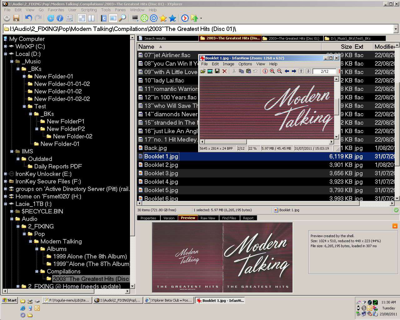

1) In the "ScreenShot.jpg" image attached the Xyplorer preview size is: 1024x510 for an image "Booklet 1.jpg", same file is open in infranview and size is correct (statusbar): 5645x2814

1) Ah, as you see in the preview tab, there is "Preview created by shell". This means the preview is actually the largest thumbnail the shell is able to create for an image (which happens to be 1024 x 510 in this case). Now why the shell? Because XY's internal preview failed for that picture, probably because it is too large. Note that "too large" varies from system to system (current RAM and also other factors play a role, I never found out the exact criteria).Yogui wrote:Thanks for keeping my questions numbered!![]()
