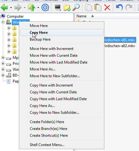

admin wrote:I need to fully understand how you copy. Please describe exactly (with screenshot of possible) how you copy to clipboard and how you paste in to the target location. Are you seeing a statusbar message "shell copy done" when copying to clipboard?
When I copy with ctrl c and Paste with ctrl v it is recognized as a background job and works
But I normally right click on the file, hold the right click, move the mouse to the location, release click and select in the
xyplorer menu copy here.
There is no job in background job list of that.
The weird is thing is just that it worked all the time with the older beta versions.
Posts: 65180
Re: Copy freeze
Thank you, that helped. Fix comes with next version.
In the meantime, as workaround, you can set this tweak:
BJAllowDropFromOutside=1
schehf
Posts: 22
Joined: 09 Apr 2011 11:50
Re: Copy freeze
Post by schehf »
admin wrote:Thank you, that helped. Fix comes with next version.
Thanks, tweak works perfectly
