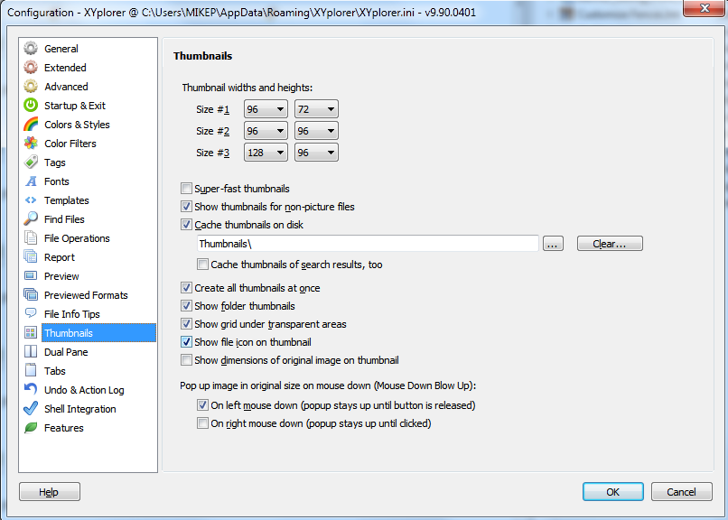

Hi Don
Yes - Saw that in this post and tried it.
These are my Thumbnail Configs:
16-02-2011 02-50-08 PM.png (80.55 KiB) Viewed 1600 times
I have installed that latest Nikon Codec's and Am On Windows 7 Pro 32 Bit
Thanks
MikeP
PS - Switch off Super Fast because the Preview seemed to Pause before displaying so thought it may be a time out problem.

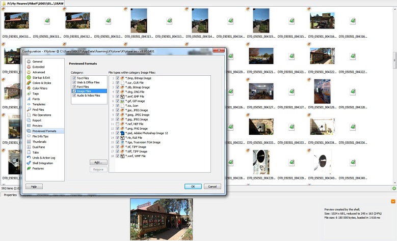

When you preview a NEF on the Preview tab, does it say "Preview by Shell" or so?
mikep
Posts: 10
Joined: 16 Feb 2011 11:49
Re: NEFs from D700 show as bad image icon
Post by mikep »
Yes - Preview by Shell on Right of Preview Screen
Posts: 65161
mikep wrote:Yes - Preview by Shell on Right of Preview Screen
Try this: open Configuration | Previewed Formats | Image Files and uncheck NEF in the list of file types. This will force using the Shell for thumbnails creation in Preview and Thumbnails.
EDIT: Correction: It will force using the Shell for thumbnails creation in Thumbnails, but NOT in the Preview. It will actually prevent the files from being previewed on the Preview panel. Obviously a better solution is needed here...

Cool :D ... but see my EDIT to my previous post. Aren't you missing the Preview on the Panel now?

But don't you get a message "File type excluded from preview" and need to press a button to preview it anyway?

mikep wrote:Hi There
I am getting a "Bad Image" for all my NEFS (D70, D70s, D80,D90,D200 and D300)
I can view the Files (Thumbnails) in Windows Explorer and also in the F12 Preview Pane (Its comes up with Cannot Decode and then a pause later displays the picture)
What should I do the Enable thumbnails for NEF's ?
have you ticked Configuration | Thumbnails | Show thumbnails for non-picture files?
Don
A bit strange to define non-picture files for picture files :roll:
As .nef are (Nikon-)picture-files in RAW-format.
I don't know if you remember: .nef have imbedded thumbs for preview.
Edit: missed the last posts when answering :oops:
But it's still correct.

mikep wrote:Nope :shock:
I just click on a Thumb in the view, Hit F12, Select the Preview Tab, and wait a few seconds.
Ah Ha - But if I close F12 - and then hit F11 I get a - this file has been exclude from preview in configuration.
And a Left Click Hold brings up a Preview
Does this help ?
Regards
MikeP
Ah yes, I see now, thanks. It depends on the system. On my system the shell cannot preview NEF and I get the button I talked about. Built in smartness has been smarter than me...
Anyway, next version will give you an option for a smoother handling:
    + Tweak to force shell preview for file types of your choice. For
      example (list of extensions separated by dots):
        DoPrevShell=dng.nef
      This will force shell preview for DNG and NEF files on the Preview
      tab and with Thumbnails.
