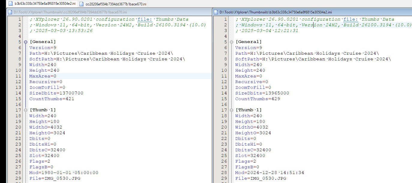

Hey Don. Happy New Year. How is it possible that I ended up with 2 thumbnail cache file pairs (ini and dbits) for the same identical folder with the same thumbnail size when the cache file name is based on the hash of file name and thumbnail size and zoom settings? I thought it shouldn't matter if some of the images/thumbnails have different mod dates as they do. Nor should it matter that the total number of thumbnails is different or if the image folder was refreshed at a latter date. In this case, the thumbnails would be rebuilt due to a refresh, CID #501 or due to a changed mod dates, but the file name should be the same. Shouldn't it?
The pic below shows the 2 cache ini files where you can see identical folder and file names and thumb size and both are not zoom to fill. I'm just curious as to how it can happen and should it happen at all (i.e., what's causing the different cache file name)? Is it possible that the new cache is due to v26.90.0108 - 2025-02-26 12:04 change viewtopic.php?p=227798#p227798? \
Thanks. Sorry, I know we've been through this before. Thumbnails get rebuilt for a number of reasons, but why in this case would a new cache file name be used (i.e., a different hash)?

Yes jupe both are listed in the XYthumbs.txt file as:
H:\Pictures\Caribbean Holidays Cruise 2024\|240x240|b3b63c338c34750e6a8f6815e30504e2
H:\Pictures\Caribbean Holidays Cruise 2024\|240x240|cc28206ef594b7394dd3677b1bace670
When I ran text get("thumbs_cache"); in that image folder the result was: D:\Tools\XYplorer\Thumbnails\b3b63c338c34750e6a8f6815e30504e2.dbits - the first on list. Just seems a bit odd in that XY would use a different hash file name for the same folder and thumbnail size both no zoom regardless of the dates and image file mod dates.

With each .dbits file there is an accompanying .ini file that you can read in any text editor. Compare the two .ini files, there should be a difference that explains the situation.

admin wrote: 08 Jan 2026 08:59 With each .dbits file there is an accompanying .ini file that you can read in any text editor. Compare the two .ini files, there should be a difference that explains the situation.
That's what I did in my first post.

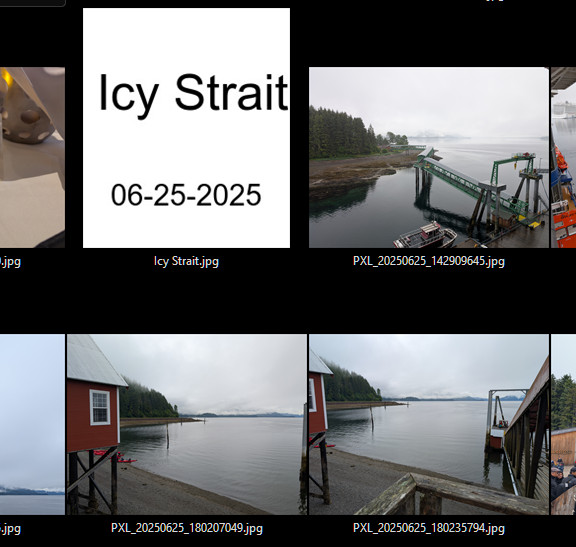

Well I'm starting to believe it has something to do with running this small script below. It simply places a label thumbnail file in the image folder at locations the user selects. I'm not sure how it may be affecting the thumbnail file name - the actual hash. This folder of an Alaska trip has a thumbnail cache file named:
D:\Tools\XYplorer\Thumbnails\00000000000000000000000000000000.dbits How can that happen? Maybe something is a bit wrong with the way the hash is calculated? I even ran a full #501 to refresh that entire folder (590 images) and it still (re)used the same hash file name for the cache. The script does a #506 to refresh the new image file (the label thumb). Performing a refresh on a selected file shouldn't affect the thumbnail cache hash filename.
This Alaska trip folder and the other one above, "H:\Pictures\Caribbean Holidays Cruise 2024\" are the only 2 that seem affected and are the only 2 folders I've used the above script.
label thumb.jpg (72.4 KiB) Viewed 177 times

I have a good feeling that it may be due to the label image file generated by Image Magic (e.g., 235x251). The image file dimensions are proportionally based on the text length and point size and not a standard which XY could then generate a thumbnail image properly.
The ini and dbits files are what they are and viewing the thumbs actually works, but that probably happened due to incorrect input like an thumbnail in the folder that's not 240x240 (my thumbnail size #3 setting) and the subsequent refreshing of that thumbnail. So the hash ended up as it is bullsh**. :)
