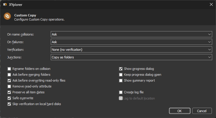

Can you show what settings you have here:

Windows 11 Pro; 100% scaling
