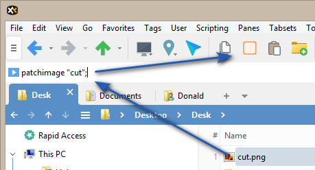

Thank-you for posting this. Your screenshot shows that your Scissors 'cut' icon is not being changed either.
So, it's not just me. This has to be a bug.
Edit: Confirmed.
I loaded up a backup of my old HD into VMware Workstation. It was running v26.30.0000. The command patchimage "cut"; successfully changes the toolbar icon. So I upgraded it to v.27.20.0100 and tried again. The cut icon will not change.
