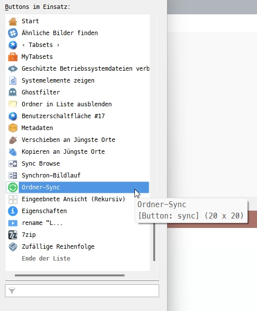

My experiences with XY aren't that profound yet, but I copied this button from instructions and that's how I make my backups..

Yep, Native2904 points into the right direction: check out the sync command.
This is air code (not tested), but something like this should work you:
sync "D:\XYtest\test1\", "D:\XYtest\test2\", 1, 0, 0, "ckn";
