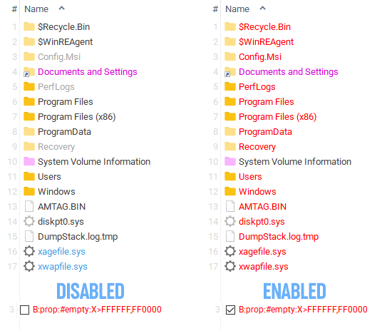

This is how proposed rule looks like.
To check, the required rule I've also change the icon and we see that it is the only one that works correctly.

In this case the result looks like the one expected.
I see several problems
- When inserting a filter, the colors specified in it are not applied (in the second img column you can see that the original coloring is overwritten by the default black)
- If you assign colors manually with the buttons, they are applied, but since the filter itself does not work correctly, the wrong ones items are highlighted
Visually it seems that it is simply inverted...

I see the issue, you shouldn’t have the colors at the end of the definition, remove them and set via btns instead or add it via list mgmt instead.

jupe wrote: 15 Jul 2025 10:36 I see the issue, you shouldn’t have the colors at the end of the definition, remove them and set via btns instead or add it via list mgmt instead.
You are right, thx!
B:prop:#empty:X
+ manual color set works just fine!
highend, thx!
