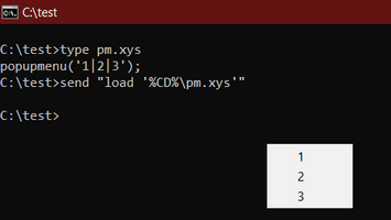

I am not sure of your exact scenario regarding what you describe as sending run cmds etc, but just FYI you can already use popupmenus via wmcopydata with XY staying in the background, eg
so something else might be causing it on your end, or the way you are implementing it. It's been my experience that when using copydata, XY usually only comes to the foreground when a dialog is called, unlike when using feed, then it always is shown.

Hi jupe, I noticed in your pic that you use send.exe. send.exe popupmenu("1,2,3") and send "load '%CD%\pm.xys'" Is that a compiled AHK script or something similar using Send_WM_COPYDATA or viewtopic.php?p=227057#p227057?

Well we must have different ideas of what a simple case is, the script you posted isn't really runable for anyone without those text files, but anyway I left most of your script intact and just changed the readfiles to a file that should exist on anyones computer, and kept the rest of your script, but just added 1 line to create a popupmenu with a couple entries that are runable, and for me xy stays in the BG when I run it, if it doesn't work for you then you should be able to test it with the XY_Send that klownboy linked to, and if that works then you will know the issue is in your implementation of WM_COPYDATA. BTW the msg I am sending is just ::load 'file.xys';
   if (exists("C:\Program Files\Dyalog")) {// if dyalog is not disabled atm
       //$proj = readfile("<xyscripts>\AppLauncher-DyalogMenu_1.txt")
       $proj = readfile(<xytagdat);
    } else {// dyalog IS disabled...
       //$proj = readfile("<xyscripts>\AppLauncher-DyalogMenu_0.txt")
       $proj = readfile(<xytagdat>);
    $proj = listfolder(<xydata>, "*.ini", 1, <crlf>);  // ADDED ONLY THIS LINE JUST TO POPULATE THE MENU EASILY
    if ("<curitem>" == "") {
        $proj =  regexreplace($proj,"^.*<curi" . "tem>.*$","");// don't use <curitem> when looking for it as a string
    $sel = popupnested($proj);
    end $sel == "";
    if (":" == substr($sel,0,1)) {
        $sel = substr($sel,1,strlen($sel)-1);
        $sel = replace($sel,"⋄⋄",";");
    } else {
        $sel = "run ". quote($sel);
    load $sel, , "s";
@klownboy: It is actually an app my brother made for me with a lot of customization I asked him to implement, but I just tested the one you linked to, and it functions the same in this scenario. I used to use my own heavily customized ahk version I cobbled together from posts on the forum, I think the orig was called messenger, but I no longer do.
