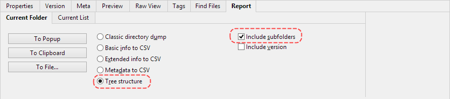

This report feature does something similar:

You use what Don posted with the button "To Clipboard" and then execute this script afterwards:
$indention = " "; // E.g. 4 spaces
// Get only folders
$result = formatlist(<clp>, "f", <crlf>, "*<DIR>*");
// Remove unnecessary stuff
$result = regexreplace($result, "; <DIR>;.+?(?=\r?\n|$)");
// Replace indention
$result = replace($result, ". ", $indention);
// Remove leading "\ "
$result = replace($result, "\ ");
text $result;
