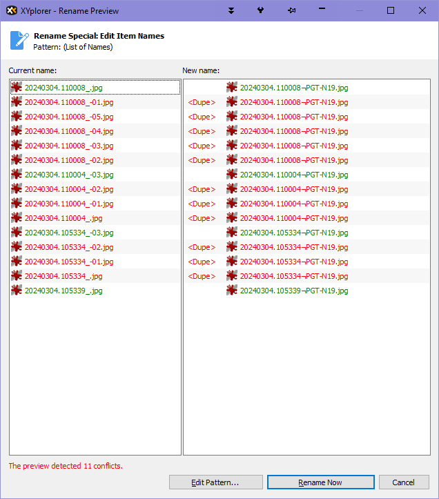

However, at times, there will be a conflicting filenames, due to same EXIF date:
I've already contacted highend privately, but I still cannot figure out on how to do that.
I am thinking of using regex at the end of the stage, but it still didn't work as expected.
Any help?

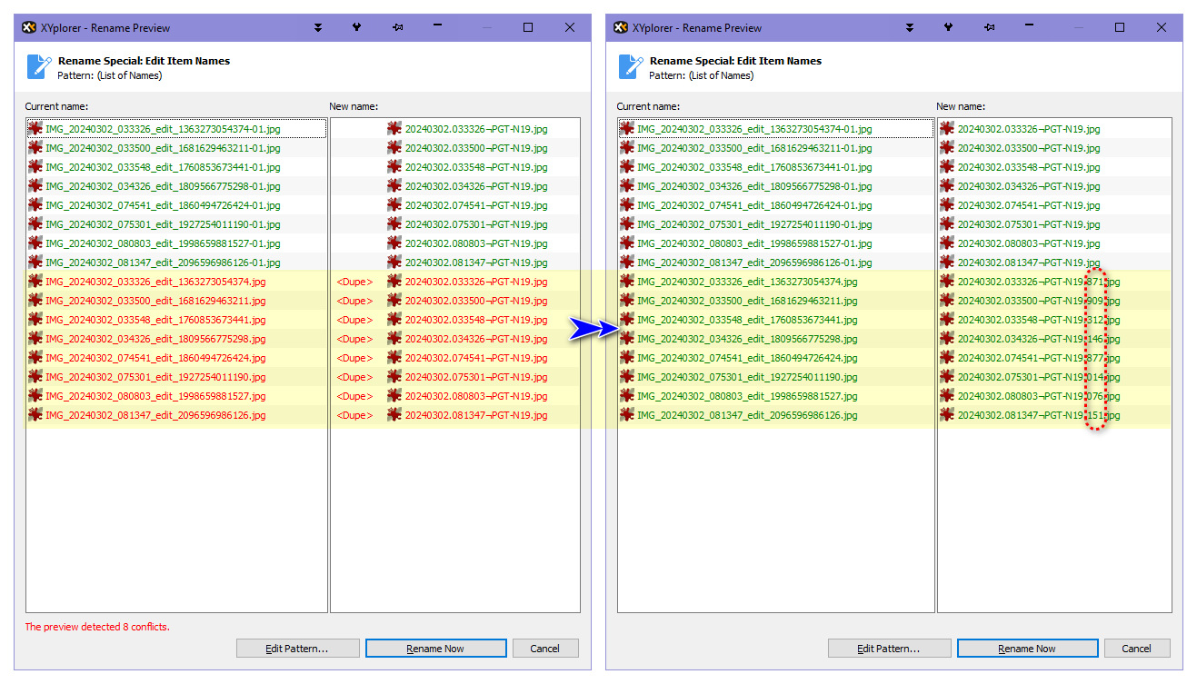

But is it possible instead of appending random number at the end to something like this.. _XX sequence number based on the duplicate occurrence.
Thanks again in advance for your help.

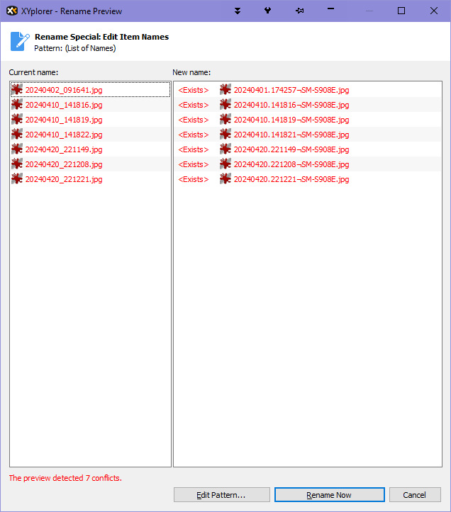

But sorry.. Is it possible to cater the scenario whereby.. The existing file already exists (previous batch renaming).
So it will come out like this.
Is it possible to rename those automatically with the duplicate extension?
