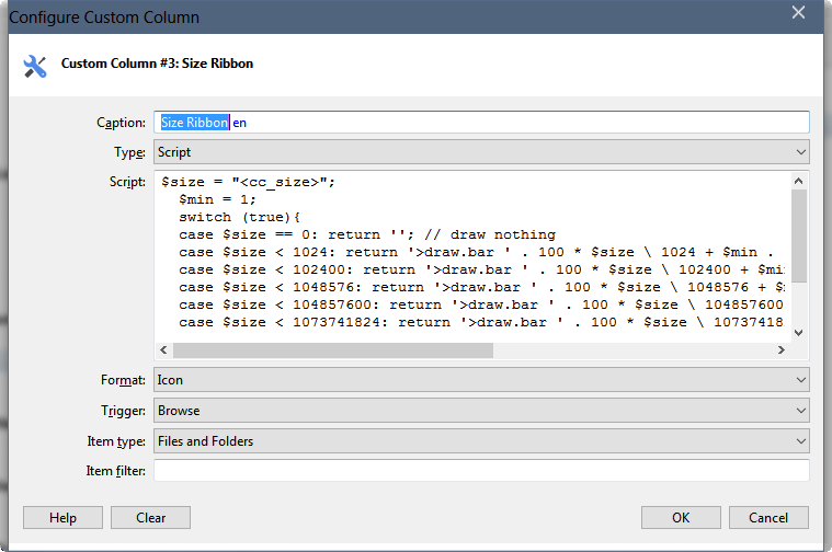

I have СС with Type = Script, Format = Icon, Item Type = Files and Folders. The script creates a coloured ribbon depending of items size, the size calculation if cached so it's always available. But for some reason no matter if i use Trigger = List or Browse - the column is never fully filled and i have to manually refresh each visit. As Help states Browse should create whole column on visit, List ought to create only for part of items currently visible in List and get filled along the scroll of user - but both don't work fully/properly, so obviously i'm doing smth wrong.

Here's the CC script:
$size = "<cc_size>";
  $min = 1;
  switch (true){
  case $size == 0: return ''; // draw nothing
  case $size < 1024: return '>draw.bar ' . 100 * $size \ 1024 + $min . ', E0E2ED'; //smaller 1KB  grey
  case $size < 102400: return '>draw.bar ' . 100 * $size \ 102400 + $min . ', D500FA, E0E2ED'; //smaller 100KB  violet
  case $size < 1048576: return '>draw.bar ' . 100 * $size \ 1048576 + $min . ', 7B20A3, D500FA'; //smaller 1MB  indigo
  case $size < 104857600: return '>draw.bar ' . 100 * $size \ 104857600 + $min . ', 304FFF, 7B20A3'; //smaller 100MB  blue
  case $size < 1073741824: return '>draw.bar ' . 100 * $size \ 1073741824 + $min . ', 13DD17, 304FFF'; //smaller 1GB  green
  case $size < 10737418240: return '>draw.bar ' . 100 * $size \ 10737418240 + $min . ', FFFF01, 13DD17'; //smaller 10GB  yellow
  case $size < 53687091200: return '>draw.bar ' . 100 * $size \ 53687091200  + $min . ', FF7900, FFFF01'; //smaller 50GB  orange
  case $size < 1099511627776: return '>draw.bar ' . 100 * $size \ 1099511627776  + $min . ', FE0000, FF7900'; //smaller 100GB  orange
  ;default: return '>draw.bar ' . 100 * $size \ 1099511627776 + $min . ', FE0000, FF7900'; //from 100GB to 1TB  red
So CC can't work with cached sizes? Then how Refresh on column makes it work, though no recalculation of folders was made?..
The CC settings:
When i visit location with this column added, first i see this:
after Refresh on column, coloured ribbons appear on folders too.

Indeed closing } was lost and ; probably was a miss-use of commenting a command while experimenting(sometimes a forget which script lang uses what sign for comments). Still after fixing those 2, situation didn't change.
Your code proposition seem to work, bars start to show, but 2 "problems" arise:
1. it involves actual calculation each time location is visited, which not only involves additional I/O, which i try to escape with cached sizes use, but yet the opening of location takes some noticeable time;
2. when i use initial script and bars don't show for folders, a mere use of Refresh on CC gets all bars in a moment = not only that's faster for location opening speed, yet no calculation is involved.
So i'm back to initial "question": why CC doesn't show bars from the start if Refresh doesn't seem to actually do any extra calculations. Feels like XY may have some flaw in co-working of CC and cached sizes, so CC doesn't actually get caches on visit and reads those only on Refresh(maybe smbd can check/prove that).
