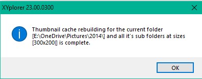

:( I'm not able to get it to work as I expect it to. Strange things happen. It does not appear to FULLY create thumbs for subfolders. My laptop has a C drive where the programmes reside, and an E drive where the pictures folder lives.
Having had problems with 1.19 I'd first used the script to "Empty Entire Thumbnail Cache" so that I was starting with a clean sheet.
I chose a folder from 2014 which has subfolders for each month, and started with a Left Mouse button click to activate the 3rd menu option - "Build Thumbnail Cache... current folder & subs". It takes only a very few seconds, then says it has completed, but there are no thumbnails.

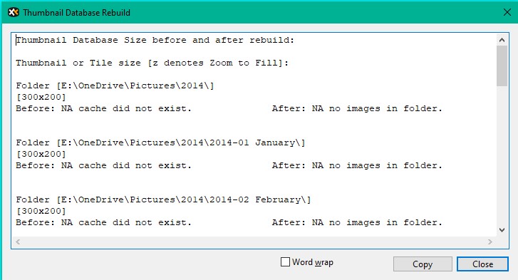

The script completes and gives the popup saying there were no images.
Screenshot 2022-05-21 XYplorer - THumbnail Maintenance Script 1.20 no images.jpg
Screenshot 2022-05-21 XYplorer - THumbnail Maintenance Script 1.20 no images.jpg (88.26 KiB) Viewed 6168 times
But there very clearly are images :?

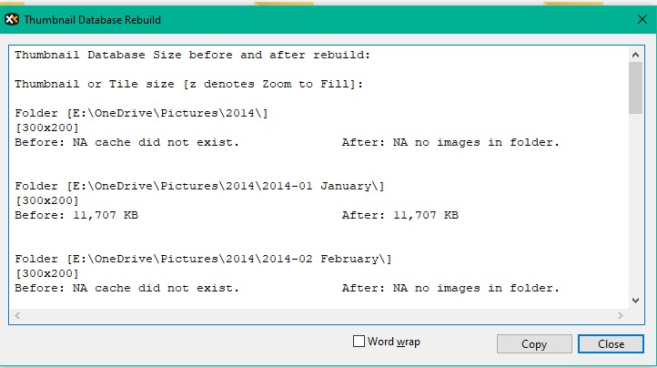

So I used the standard menu item in XYp to create all thumbnails for January, which it did. Then I ran your script again. It showed a thumbnail cache for January, but still none before or after for any other subfolder.
Thumbnail Database Rebuild - after using XYp to create the thumbs in January.jpg
Thumbnail Database Rebuild - after using XYp to create the thumbs in January.jpg (49.52 KiB) Viewed 6168 times

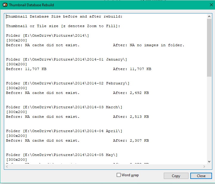

:? But I don't understand the cache sizes. All thumbs are at 300*200.
January was 79 images and had thumbs created by XYp - 11,707 KB of cache.
February has 74 jpgs with thumbs created by script - 2,492 KB of cache
June has 472 jpg images - cache size 2,738 KB.

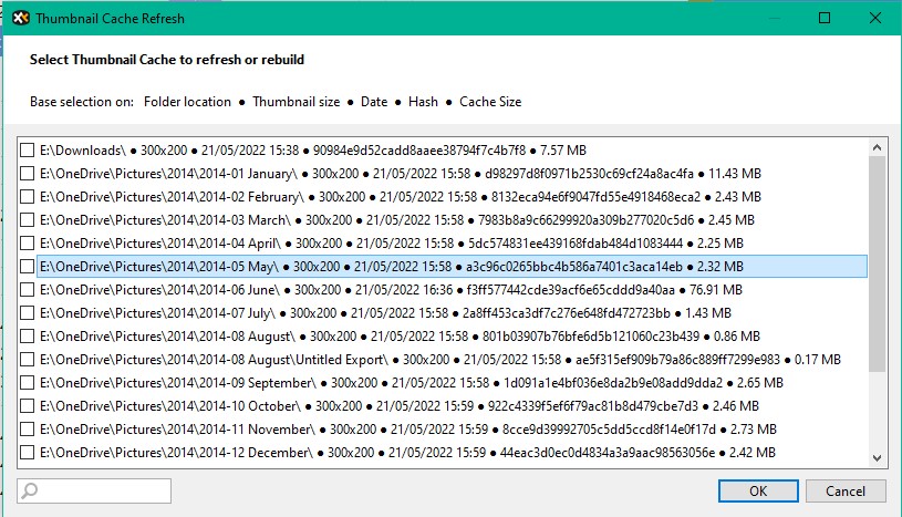

THumbnail - rebuild cache from DB.jpg (152.96 KiB) Viewed 6168 times
It took about 30 seconds, and the cache for that folder increased from 2.32 MB to 91.30 MB.

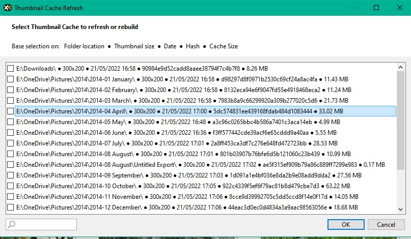

I went back to Script menu item 1, and selected all subfolders, to create at current sizes. That took almost 9 minutes. At one point I got an "Error 91" popup from XYplorer, but it disappeared before I could screenshot it, and I didn't see what it referred to.
Every other folder cache was now significantly bigger, and opening a folder showed the thumbs were successfully created by this action.
THumbnail - rebuild cache from DB - select all subfolders - result.jpg (156.52 KiB) Viewed 6168 times
