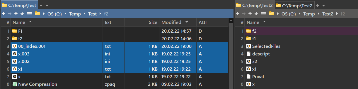

Thanks for the dual pane version
but I always get the following error
XYplorer 22.90.0100
The following source item does not exist:
C:\Temp\Test\$selectedItems
Click OK to go on anyway, or Cancel to terminate the file operation.
OK Cancel
Its trying the following for a copy
Windows 11 Home, Version 26H2 (OS Build 26300.9711)
Everything 1.5.0.1424b (x64), Everything Toolbar 3.5, Listary Pro 7.1.0.43 beta
Posts: 15012
Re: popupmenu - Add nested submenus
Try v0.4

Thanks, 0.4 works :D
