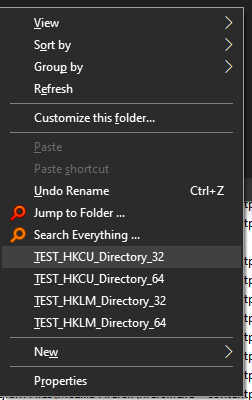

When right-clicking an empty part of a listview in File Explorer, I see the following entries:
In XYplorer, I see this (64- as well as 32-bit context menu):
Why aren't these TEST_ context-menu entries shown in XYplorer? (mostly out-of-the-box settings, btw)
The TEST entries of the context menu can be generated with the following command on an (elevated) CMD prompt:
@for %a in ("HKCU" "HKLM") DO @for %b in ("Directory" "Folder") DO @for %c in ("32" "64") Do reg.exe add  "%~a\Software\Classes\%~b\Background\Shell\TEST_%~a_%~b_%~c\command" /ve /D "notepad.exe" /F /reg:%~c
To remove these entries:
@for %a in ("HKCU" "HKLM") DO @for %b in ("Directory" "Folder") DO @for %c in ("32" "64") Do reg.exe delete  "%~a\Software\Classes\%~b\Background\Shell\TEST_%~a_%~b_%~c"

Unfortunately, that does exactly that: Pop up folder's context menu". It is the context menu that is shown when you right-click a folder.
That is different from the folder's background context menu.

Yes sorry I didn't read your post properly, I don't think you can get that background menu, but if your main aim is just to be able to add items to that folder menu you see now in XY via the Registry, you still can, you'd just need to add them in a different place instead, eg. HKCR\Directory\Shell\ or the user one etc.
