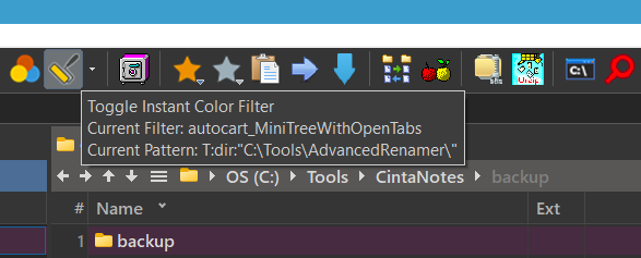

Not sure, what that means.
Well, XY does that even without the script.
Not sure. Does it now work or does it not work. I guess it does not work.
Can you check if your setup looks like on the pictures (or equivalent), please.
And the context menu should look like in the first post: download/file.php?id=16047
And then, if you open a new tab and in that new tab go to a folder that has not been open before, the highlighting does not change?
Can you post some screenshots, please, of before opening a new tab and afterwards.
EDIT: You can use
::obfuscate(); in the AB to hide private info for the screenshot.To see the attached files, you need to log into the forum.

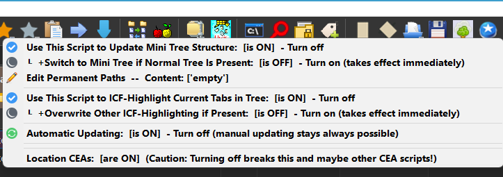

My settings are as in your examples.
The context menu of the button misses the last few entries and looks like this: I can't produce a screenshot with the highlighting
as it only occurs while I hold down the left mouse button on a new location in the tree.

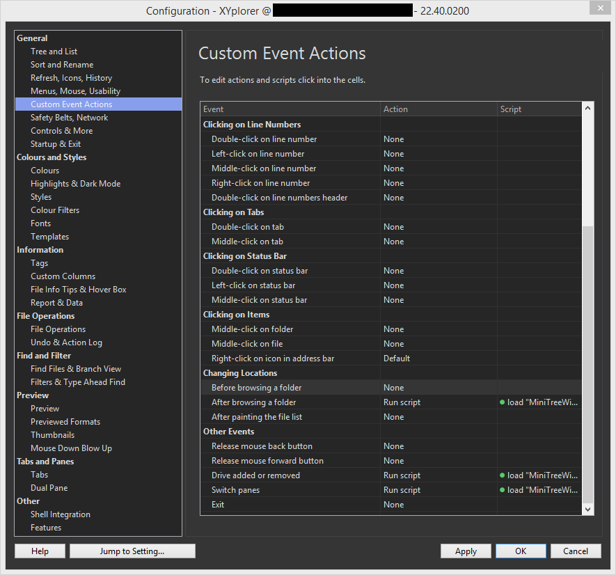

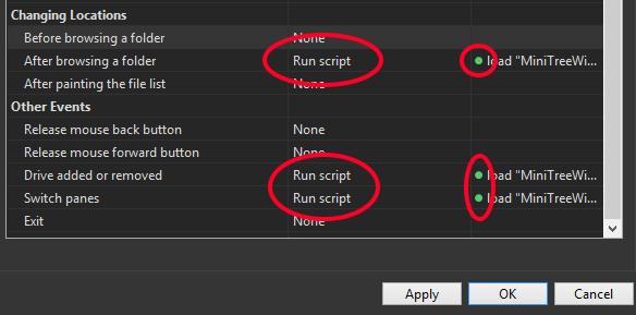

Can you double check if the CEAs in the config dialog are set to "Run script", as in the picture? This is easy to overlook. Other than that I am not sure, what could be the cause.
Unless you had a different Instant Color Filter (ICF) activated. And I see now that the screenshot with part of your toolbar does not show the "Toggle Instant Colour Filter" button. So, maybe there is another ICF active without you noticing it. To make sure the script works also in that case, just enable that option "+Overwrite Other ICF-Highlighting if Present" in the script's context menu.
If there is still nothing, then I have no more ideas.

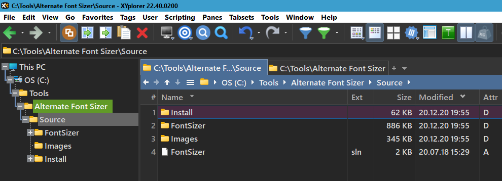

Please, Horst,
the script highlights both folders in the tree.
XY's natural own highlighting of the current folder just is more powerful and paints over the script's (or, rather, ICF's) highlighting of the current folder.
If you make the tree wide enough and look closely, you should see a tiny short green line at the right end of the current folder in the tree.
This is because the ICF's highlighting is "under" XY's own current-folder-highlighting but it is a little bit longer, thus, extends out from "underneath" and becomes a little bit visible at the right end.
However, this is all native XY behaviour and has nothing to do particularly with my script.
This is also true of other ICF highlighting.
If I may ask: Why do you as forum moderator not know these things?
