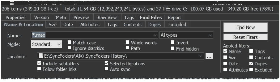

Could you post a full screenshot of XYplorer while this is happening?

I meant a screenshot of XYplorer, not of the process monitor.
Re: Possible bug with [LookIn]
Not 100% sure what you will see there but here is a screenshot after I open Xyplorer. As I said, the disk access depends on the last used [Lookin] and changes when that changes.
