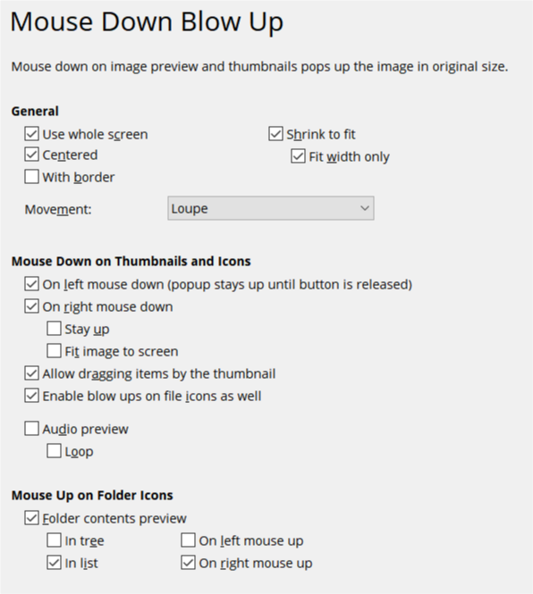

@klownboy: Cannot reproduce. Could post a screenshot of your MDBU settings?

Ideally, the behavior would be:
1) When you Left-MDBU: Image blows up to full size, with full 4 direction panning
2) When you Right-MDBU: Image blows to to 'Fit Width' with only vertical panning
The settings: Sample large image attached.
- 13585.jpg (2.56 MiB) Viewed 2070 times

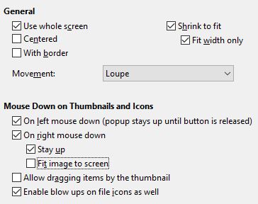

Don, try these settings on a thumbnail, On Right mouse down and Stay up checked and Fit image to screen unchecked. On right click, the blow up image is Fit to the screen and fixed at the top of the image with no movement possible. See attached.
Also with On Right mouse down, Stay up, and Fit image to screen all checked, no movement is possible on right mouse down. Was movement or scrolling intended with Stay up checked?

Not here.klownboy wrote: ↑05 Sep 2019 12:06 Don, try these settings on a thumbnail, On Right mouse down and Stay up checked and Fit image to screen unchecked. On right click, the blow up image is Fit to the screen and fixed at the top of the image with no movement possible. See attached.MDBU.JPG

I had to run off to get a tooth drilled, but what jaywalker32 stated is correct. "Shrink to Fit Screen" in the General is affecting the On right mouse down setting for Shrink to Fit. When General setting Shrink to Fit is checked and On right mouse down setting for Fit Image to screen is unchecked, you'll get A MDBU shrunk to fit on right click which is what I was originally pointing out.
Also noted with:
General settings:
Shrink to fit and Fit width only both unchecked.
On Right mouse down: Stay up checked and Fit image to screen unchecked.
I can right click (no hold) and the image comes up and stays up and does not move if I attempt further mouse actions. if I right click keeping the mouse held down, the image moves. Maybe this is expected behavior (or not)?
Also noted with:
General settings:

I'm still seeing the same 2 issues in my last post (actually the first one would be considered an issue, the second is more a question on Stay up with a single right click (not held) vs right click held down and movement). Note: I don't use these settings so it's not a huge deal for me. I just wanted to let you know.
