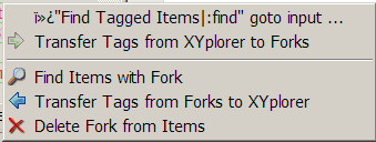

trying the new script - find some funny looking chars on the first line, but it still works (see screenshot)

Kucera wrote:Hi,
Regards Emil
Looks like the UTF-8 BOM. Don, are there any specs to follow for script files encoding?

Marco wrote: Looks like the UTF-8 BOM.
Must have been. After copying and then saving the script in plain textpad the funny chars are gone.
