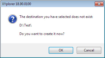

copyto "D:\Test\", "*C:\ArmSys\XYplorer\Lists\Reading.txt", "D:\Download", 2, 1, 1;
On_Collision set as 1 won't work. The behavior is quite weird. It causes both flags and autorichop ineffective. That's, copyto won't create non-existing folders in destination as expected.

That's exactly what happened. That's, XYplorer can no longer create non-existing folders.
On the other hand, after dropping the on_collision, XYplorer constantly pops up the annoying Custom Copy / Name Collision dialog, if duplicates are found.

My core question about copyto:
How to creating non-existing folders while overwriting if newer (on_collision=1)?

If switching to backupto:
  backupto "D:\Test\","*C:\ArmSys\XYplorer\Lists\Reading.txt",1;
it will pop the annoying dialog:
