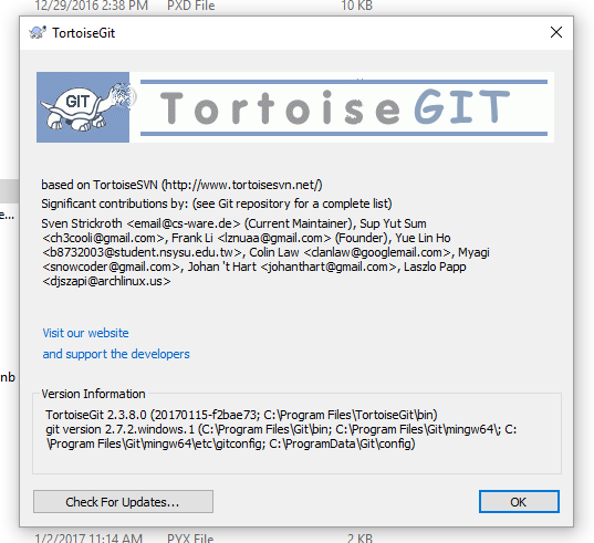

tortoise.png : the about screen for tortoise (I am showing the latest beta version but installed this only have latest stable release was not working, can roll back if you think it will help but I'm told latest beta is very stable and as noted works fine from Windows Explorer)

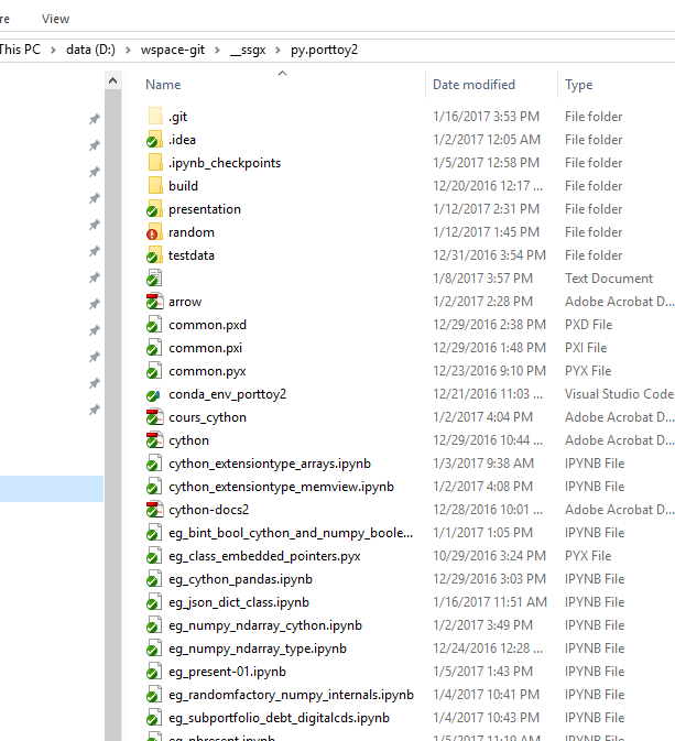

explorer.png : this is a snippet of a dir shown in Windows Explorer, shows all the icon overlays and context menu (although not in snippet)

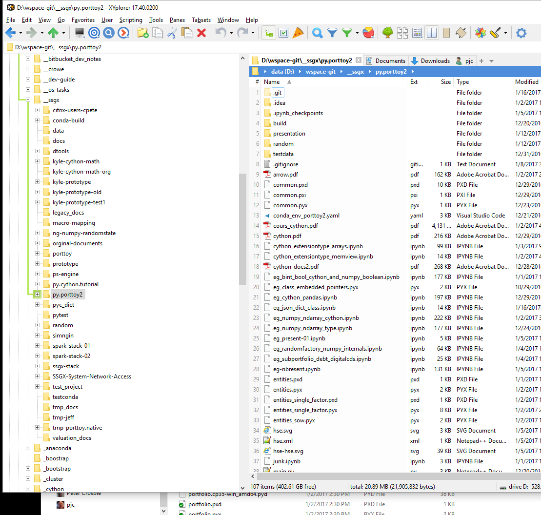

xyplorer.png : this is the same dir as shown in explorer.png but in xyplorer, no icon overlays and no context menu

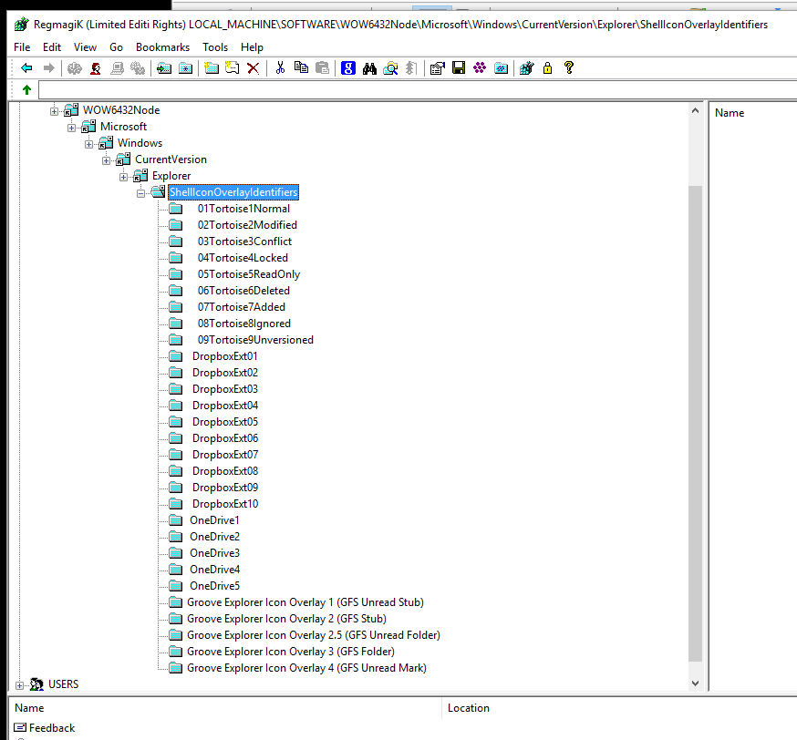

Thanks for the ongoing help; it is close. I now have the context menu but no icon overlays; although they briefly appeared after rolling back a dropbox update that renamed their icon overlays in the registry.
Some of these issues are traceable I think to a very recent update of dropbox 16.4.x -> 17.4.33, when I roll back from this update the icons appear, after the update the icons are gone. One important change in the dropbox update was their renaming of their icons in the registry to all start with two spaces and thus sorting to the top of the list. I have edited the icon overlay names in the registry to put the the TortoiseGit icons back at the front of the list but while this seems to fix the issue in other applications it doesn't in xyplorer.

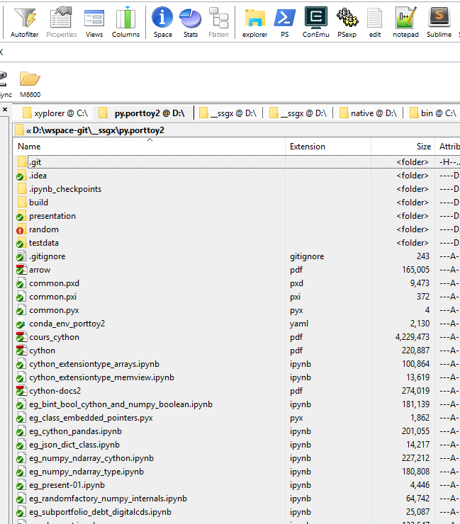

I have attached some screen shots showing xyplorer config for icon overlays checked, and an example dir under git control in windows explorer (icon overlays okay), xplorer2 (icon overlays okay), xyplorer icon overlays not visible.

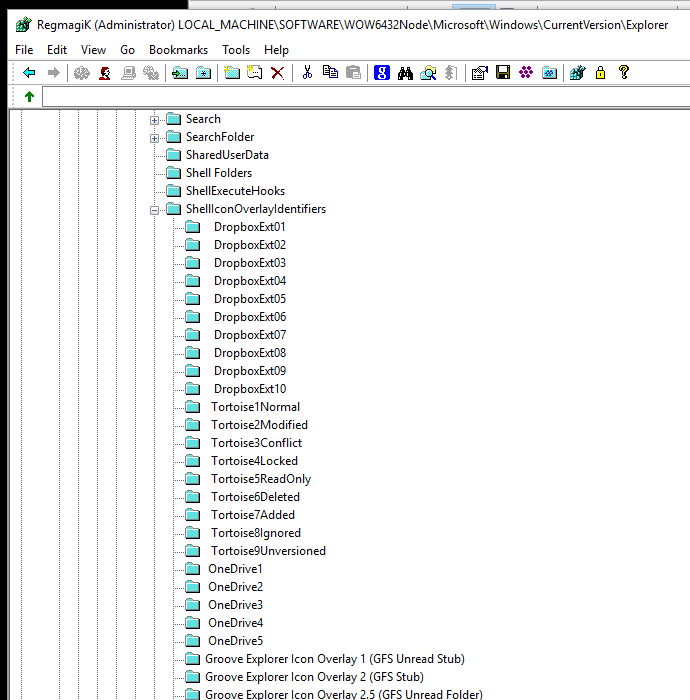

edited Wow6432Node as you suggested to ensure TortoiseGit icon overlays sort to top of list. All now works as expected. Note no changes to registry except a renaming of the icon overlays so that the sort order changes.
For anyone else following, see attached before and after registry screenshots.
