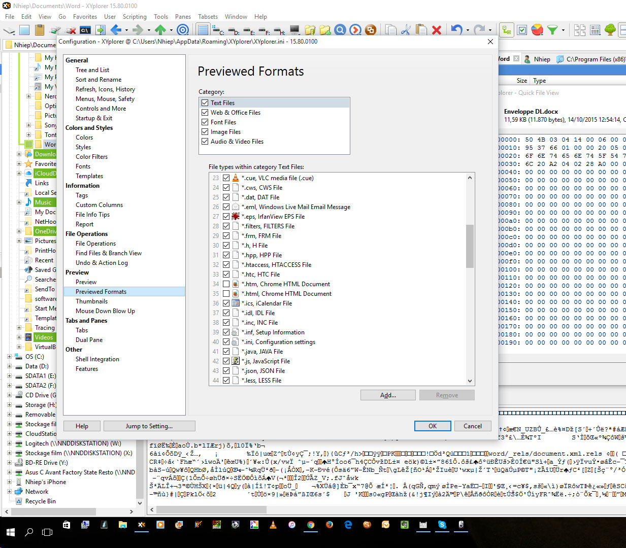

  1. Open Tools | Configuration | Previewed Formats
  2. Under Category select Text Files.
  3. In the lower File types within category Text Files pane ensure that there is not an entry for *.docx
  4. Now select the Web & Office Files category.
  5. Ensure that the lower pane contains *.docx and that it is checked.
After that you may need to deselect and then re-select the document to update the preview but it should work.

Hello,
I've done all the configuration (text files and Web files) but the results are still the same.
Thanks to the links you provide me with I understand the usage of mouse down blow up now but in my case the Mouse down Blow up works with plain text file (*.txt) but not with word files (doc or docx)

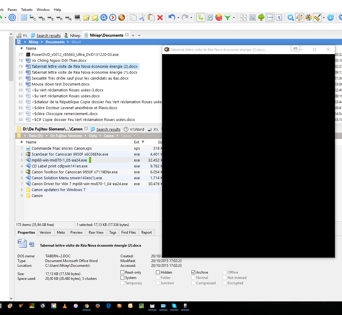

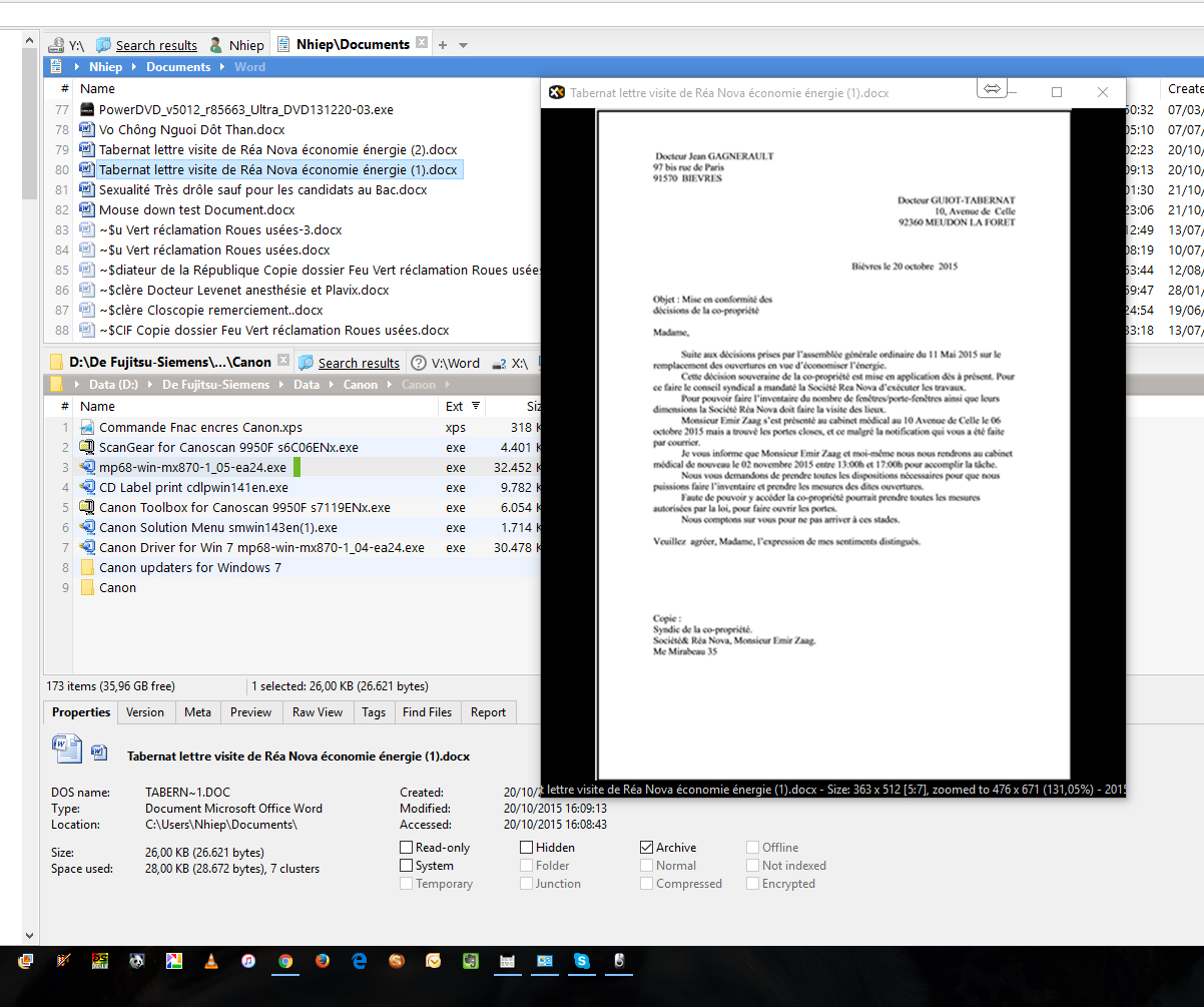

Nhiep Nguyen
Posts: 26
Joined: 03 Apr 2015 10:48
Re: Word Document Preview
Post by Nhiep Nguyen »
TheQwerty wrote:
Nhiep Nguyen wrote:The issue is not with the Wed & HTML BUT Word document preview in XYPlorer.
The only way to have Word documents rendered in the Preview pane is to enable them in the Web & Office (mis-typed previously) category of Previewed Formats.
For all file types in that category XY makes use of the WebBrowser component of Windows, which is essentially a stripped down Internet Explorer. The WebBrowser component makes use of a plugin architecture to open and display certain file types. Most commonly this is used for Office documents, PDFs, etc.
Thus a simple test to determine if XY can preview a file format in the Web & Office Files category is to attempt opening it in Internet Explorer. No other browser will tell us anything meaningful in this scenario.
Hello TheQwerty,
The situation get more confused!
As you can see from the two attachments I have two versions of the same file and one is visible on the floating Preview Pane and the other not!
I'm really lost.

Post by TheQwerty »
When someone saved the working file they configured Word to include a thumbnail.
The same was not done with the non-working file.*
To repeat:
TheQwerty wrote:Floating Preview and Full Screen Preview only show previews for anything for which XY can show thumbnails. Your list pane is in a thumbnail mode and XY is not showing contents for the docx which means those previews will not work for it.
*And in my experience attempting to add the thumbnail to an existing file by overwriting it with Save As does not work correctly. You're better off saving with thumbnail to a new file and then swapping the names.
