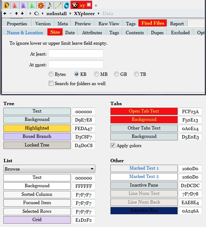

You can set your colors of choice in Configuration > Colors and Styles, second column on the right (Tabs).
I picked now this red, so you can see how it's applied - but keep in mind that what you choose will color the active tab in Info Panel, but also the active tab in the Tab bar, so better select a pleasant color.
- XY_TabsColors.jpg (121.8 KiB) Viewed 3195 times

This does not work here, no matter what combinations I try, not even with default colors. My info panel sticks to the Windows scheme. Would you mind showing a screenshot of your config-dialog?

This works for me:
TabIPUseCustomColors=1Re: Color of Tabs in Info Panel

With TabIPVisualStyle= 0,1, or 2 you can get colored "normal" tabs above the list pane provided you have "Apply colors" checked in the Configuration under Colors & Styles | Colors | Tabs section, but to get the colored tabs in the IP, you have to use Dario's suggestion, TabIPUseCustomColors=1.
Setting TabIPUseCustomColors=1 will cause the IP tabs to use the specified tab text colors.
To use the background colors as well you must also set TabIPVisualStyle to 0 or 1 to disable the flat styling.
The font color for the applied filters under 'Find Files' is controlled by the Marked Text 1 color.
To only apply the custom colors to the IP tabs leave Apply colors (TabUseCustomColors=0) unchecked.
To include the new tab and tab list buttons in your custom coloring set TabUseCustomColorsIncludePlus=1.
