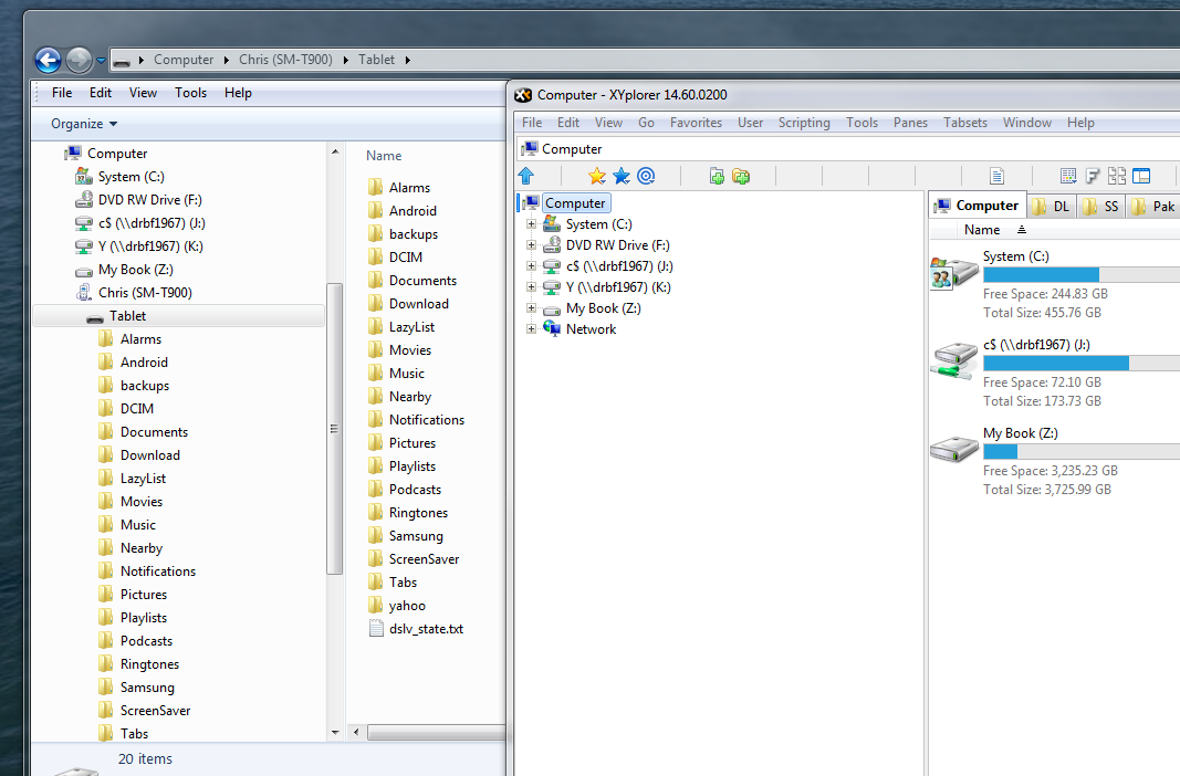

The search did not turn up any recent posts on this so what is the current status of XY accessing Android devices?
Below shows Windows Explorer on the left and XY on the right.
On the left you can see I have access to my Samsung tablet (SM-T900) and when connected, WinX also sees my HTC-M8. For both devices, as soon as I connect the USB cable they show up and I have no special software loaded (AFAIK). However, no matter what I try I cannot get XY to see the devices.

Yes, yes, known issue. I had planned it for this year, but it's really tough to do. Looks I won't make it in 2014. But it's on the top of my list. I'm losing money everyday without this feature...

No, it's because of the sheer lack of documentation and the apparent bizarrness of the implementation. The was probably designed in the darkest times of MS, deep in the Vista era...

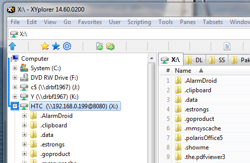

After some trial and error, WebDAV Server seems to work pretty well despite some limitations. There are a few different apps on the Google Play that provide this and below is the one I just loaded (ad version is free)
https://play.google.com/store/apps/deta ... bdavserver
Basically it allows your device to be a node on your local LAN just like a PC. It was trivial to setup, just DL, enable, then map a network drive to the IP address it displays.
The WebDAV protocol limits transferred files to 4 gig and for any files over 50m you have to hack the default Windows registry setting as follows:
HKEY_LOCAL_MACHINE\SYSTEM\CurrentControlSet\services\WebClient\Parameters
set FileSizeLimitInBytes = 4294967295
Also, if browsing your device from Windows is sluggish, in Control Panel\Internet Options\Connections\LAN Settings\
Uncheck the Proxy automatic options
The advantage is not being tethered to your PC nor having your phone go into an alternate feature mode when connecting via the USB.
It works fine for me as I transfer pictures, sound files and documents of modest size.
