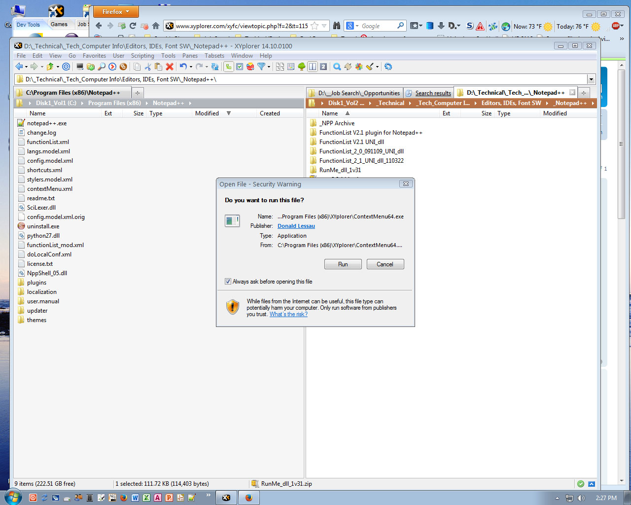

I was here a while ago regarding a problem I encountered with V14.00 when doing a right-click on a file/folder (hitting cancel typically, but not always, got to the expected right-click menu)(http://www.xyplorer.com/xyfc/viewtopic. ... ph#p103942). I also found that the problem went away after I had done a binary re-install (1st time was a copy/paste over existing files).
Well, the problem came back again in V14.10 I can't remember if I did a copy/paste upgrade this time (prob'ly did). However, XYplorer seemed to work fine....until I changed the setting (unticked the box) so XYplorer was no longer my default file browser. Right-click --> Run problem came back. I then uninstalled and reinstalled XYplorer using the installer, and it works correctly again.
Last time you asked for a screen shot. I have included a .jpg one here (no pdfs allowed?!?). Hope it helps.
Cheers....Steph
Cheers....Steph
- XYplorer with Run window on mouse right-click.jpg (240.27 KiB) Viewed 3480 times

I think I can explain the behaviour...
I don't know if it happen on every machine but on mine it would be the same (Windows 7 64 bit plus WinRAR).
When we download for example a ZIP file from the internet, such as the XYplorer ZIP package, the file has an NTFS alternate data stream written on disk (called :Zone.Identifier:$DATA). It it the thing that triggers the security warning. Now if I clear the stream and then unzip the file, every unzipped file is "clean".
However if I decompress the ZIP file without deleting the stream before, each and every file in the archive has the alternate data stream of the original ZIP file, also ContextMenu64.exe which when run triggers the warning as in the picture.

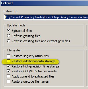

Simply go into the settings of your zipper/unzipper and untick the appropriate setting. Some zippers allow this on a per file basis, for others it's a permanent setting: I rarely need to check up on this, however, since none of my clients uses this setting, anyway.stephr1 wrote:So, going forward, how would I "clear the stream" or actually change it (can I, and to what) so I don't run into this problem in the future.
To make sure you don't, either, also check your compression options:
