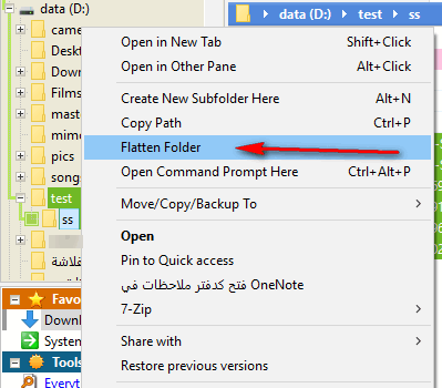

stupid question:what does flatten folder do exactly i selected folder to flatten from tree menu and didn't see any changes?
Posts: 14658
Re: Folder Flatten & Segregate script - Has anyone...?
Any now we're guessing which script you've used?

highend wrote:Any now we're guessing which script you've used?
if you mean me 8) i used tree context menu
Posts: 14658
That command asks for a confirmation before it starts, did you see that? Apart from that it: it works fine with the current beta...

It flattens the selected folder. All subfolder contents are moved to the root, that is, the selected folder in this case.

so the selected folder must contains at least one sub folder-not only files-to do its job,thanks :tup:
