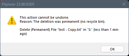

You know, I'm getting that same CTRL+Z error:
CTRL+Z works fine on this mapped drive letter when using Windows Explorer.
I am pretty sure CTRL+Z was working at the time I made the post I referenced above, could go get old versions from the Freezer to test that theory.

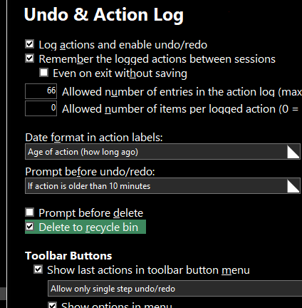

I do have Delete to Recycle bin selected:
