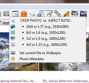

Hi, Photo Crop is my first real script I've posted. Simple, but I hope you can get some use out of it. Photo crop may come in handy for quickly converting your personnal photos or wallpapers downloaded from the internet from one aspect ratio to another. Most often I use it to crop personnal phots to the aspect ratio of my computer monitors. The script will work best saved to a customizable toolbar button (left or right click). Select one or more images in XYplorer, click the CBT, and select the aspect ratio you want to change the photo "TO". It does this by cropping the image in either the x-axis or y-axis as appropriate, not resizing them. So the original quality of the image is not lost or reduced by shrinking or expanding the image. Though it works for multiple selected images, in most cases you'll want to evaluate where the cropping will occur so you'll want to look closely at the picture (or thumbnail) to determine if you want to offset the default center crop in either the x or y axis as appropriate. The script uses Irfanview to perform the actual cropping so you will have to point to where you have it installed or install it first if you don't already (i.e., modify $g_IrfanPath=D:\graphics\irfanview...near the end of the script). Please change those icons in the headers. I don't use these. For this uploaded script, I used icons built-in to XYplorer so everyone would have them. Beware of wrapping.
 // Photo crop may come in handy for quickly converting your personnal photos or wallpapers downloaded from the internet from one aspect ratio to another.
 // The script will work best saved to a customizable toolbar button (left or right click). Select one or more images in XYplorer, click the CBT, and select the aspect ratio you want to change the photo "TO".
 // It does this by cropping the image in either the x-axis or y-axis as appropriate, not resizing them. So the original quality of the image is not lost or reduced by shrinking or expanding the image.
 // Though it works for multiple selected images, in most cases you'll want to evaluate where the cropping will occur so you'll want to look closely at the picture or thumbnail to determine if you want to offset the default center crop in either the x or y axis as appropriate.
 // The script uses Irfanview to perform the actual cropping so you will have to point to where you have it installed or install it first if you don't already (i.e., modify $g_IrfanPath=D:\graphics\irfanview...near the end of the script)
 // Please change those icons in the headers.  I don't use these.  For this uploaded script, I used icons built-in to XYplorer so everyone would have them.
 // Thanks to Stefan, SkyFrontier, highend, and PeterH for getting me through some issues.
" CROP PHOTO   to   ASPECT RATIO|:cut"             // see sub "_ExecuteIV" to modify Irfanview path to suit your installation

"Set current file as Wallpaper|:previewfull" run "D:\Graphics\IrfanView\i_view32.exe <curitem> /wall=3 /killmesoftly"
"Photo Metadata|:meta" #197;                    //C:\Windows\System32\shell32.dll /22
