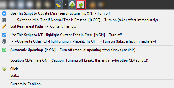

Once the script is set up (see "SET UP" below), the script's behavior is primarily controlled through a Custom Toolbar Button (CTB). Left-clicking the button will run the script once. Right-clicking it pops the CTB's context menu that allows to turn on or off automatic execution. It also gives access to the script's other settings. The settings are remembered across sessions. They are the following:
  • Use This Script to Update Mini Tree Structure
    Possible values: [is ON] or [is OFF] (can be toggled)
    When turned on, the script will immediately try to trigger an update of the Mini Tree's structure, as described in "INTRO" above, and then do so again each time it is run. Whether or not the Mini Tree gets activated, whenever it is not active already, is controlled by the next setting.
    When off, the script will leave the tree as is, be it the Mini Tree or the normal tree.
  • +Switch to Mini Tree if Normal Tree Is Present
    When turned on, then the Mini Tree will get activated on each structure update if it is not already active. Turning this setting on will also try to trigger an update of the Mini Tree structure immediately.
    When off, the Mini Tree can only be updated if it is active. If the normal tree is active, the Mini Tree will not get activated by running the script.
  • Edit Permanent Paths
    Possible values: User specified paths
    When clicking this entry, a dialog pops up in which paths can be entered - or existing ones edited - that should always be included in the Mini Tree generated by the script. One path per line. The paths are remembered across sessions.
    The script will check the paths for existence as soon as the dialog is "OK"ed. If "wrong" paths have been entered that the script cannot find, then this is pointed out to the user in separate message boxes, one for each "wrong" path. Such paths will most likely not appear in the Mini Tree. However, this is also influenced by the setting "Tools > Configuration... > General > Controls and More > Miscellaneous > Allow zombies in the Mini Tree". (Be aware, though, that when UNticking this XY setting, XY must be restartet for the unticking to take full effect. See also viewtopic.php?f=2&t=23680.)
    At least any string that is not in the format of a path at all, should normally not appear, with the exceptions of "special paths" (see below). Unfortunately, paper folders are among those strings that are not supported by the tree of XY. Because one might wonder and try to add one anyway, a special warning message will pop in case that a paper folder was entered, even if that should be rare.
    "Special paths" are supported by XY's Mini Tree. That would be: "Desktop", "Documents", "Downloads", "Links", the user folder with its name, "Network", and "Recycle Bin", yet, these have to be entered with their localized language names, as far as I can tell from how it works here for me. Ofc, if your OS language is set to English, then ... :whistle:, well I might have the English names wrong, so double check for yourself. I cannot think of any other "special paths" right now, besides "This PC" but that is anyway included in the tree at all times.
    Still, you can try anything. If the script does not recognize it as currently available, it will pop a warning message upon "OK"ing the dialog but still save it and foreward it to the tree. The tree might then show it or not.
    An interesting application of ths is to untick "Allow zombies in the Mini Tree" (see above), add all possible drive letters to the script's "permanent paths", and call the script also from the CEA "Drive added or removed". Thus, e.g. any USB drive will automatically be added to the Mini Tree, when it's available, and hidden, when it's disconnected.
  • Use This Script to ICF-Highlight Current Tabs in Tree
    When turned on, the script will immediately try to trigger an update of the script's highlighting in the tree with the use of Instant Color Filters (ICFs) and then do so again each time it is run. Whether or not any existing ICF-highlighting is replaced, is controlled by the next setting.
    When off, there will be no highlighting by the script. If some other highlighting is activated, it is left untouched.
    The colors can be customized in the 3rd line of the script's code. The factory settings are white text on green background.
    Highlighting can also be toggled on and off by using the Instant Color Filter's toolbar button, however this does not change any of the scripts behavior when being run.
  • +Overwrite Other ICF-Highlighting if Present
    When turned on, the script will overwrite any existing ICF-highlighting that might be present. Turning this setting on will also try to trigger an update of the script's highlighting immediately.
    When off, the script only updates the highlighting when no other ICF-highlighting is present. If other highlighting is present, it must first be toggled off, so that the script can take effect again.
  • Automatic Updating
    When turned on, the script will run once immediately and then each time that a location change or pane switch occurs.
    When off, the script will not run automatically.
    As mentioned above, the script can always be run manually by left-clicking the script's toolbar button, regardless of the automatic behavior. Being able to run the script manually can sometimes be helpful, since it is not possible for the automatic behavior to work all the time (see "KNOWN LIMITATIONS" below). Some people might also prefer to generally turn automatic behavior off and run the script only by hand.
  • Location CEAs
    Possible values: [are ON] or [are OFF] (can be toggled)
    The context menu of the script's CTB finally shows an extra option to turn XYplorer's "Changing Locations" Custom Event Actions (CEAs) on and off all together. This option is only meant for people who know what this is doing. Under normal conditions, this setting should always be kept on.

:?: SET UP
The script is primarily intended to work with the location change CEA "After browsing a folder" in order to update the tree on each location change and with the CEA "Switch panes" to update the tree on each pane change. Download the script file from the "DOWNLOADS" section (and remove the version number at the end) or copy and save the code and load that script file from inside of the location change CEA "After browsing a folder", for example, with load "MiniTreeWithOpenTabs_curLocExpanded_tabFoldersHighlighted.xys", "main"; as well as from within the CEA "Switch panes" to work also when switching panes. One might also want to load it from within the CEA "Drive added or removed" (compare "OPERATION and SETTINGS" > "Edit Permanent Paths" above). Of course, the script file name must be adapted if you save it under a different name.
Hint:
Activating the setting "Tabs|Reuse existing tabs when changing the location" in the configuration dialog will make tabs be reused, even when changing locations through the tree. I feel that this is very practical.
Toolbar Button
Technically the script will work also without the toolbar button. The factory defaults for the settings are:
  • Use This Script to Update Mini Tree Structure: [is ON]
  • +Switch to Mini Tree if Normal Tree Is Present: [is OFF]
  • Edit Permanent Paths: [empty]
  • Use This Script to ICF-Highlight Current Tabs in Tree: [is ON]
  • +Overwrite Other ICF-Highlighting if Present: [is OFF]
  • Automatic Updating: [is ON]
  • Location CEAs: This is an XY setting and can be changed also outside of the script.
However, I would recommend to add a user button to the toolbar to be able to call the script manually and change the script's settings on the fly. To do so, add a Custom Toolbar Button (CTB), copy the code under "Snippet Code for the Toolbar Button" from the "DOWNLOADS" section, and paste it as a snippet into the CTB. This is done by editing the CTB's properties (right-click on the CTB and clicking "Edit...") and then pasting the previously copied snippet code through the right-click context menu of the "Clear" button in that "Edit User Button" dialog. (Another method of adding the CTB is shown here: snippet lab.) As icon for the toolbar button I chose the original Mini Tree icon with a colored square as background. It can easily be changed in the very same edit dialog.

I like the script and the configuration works
but something is wrong with the highlighting or I misunderstand it.
If I switch highlighting on the active entry of my 2 pane tabs are colored white on green.
If I now change the active side or go into some other dir on the active side this never changes the highlight.
So in short the highlight doesn't follow my changes in the list tabs
and also not if I click on some other dir in the tree which changes the tab in the active pane to it.
Therefore I switched off highlighting and also use the manual mode of updating the tree.

First, thank you for commenting at all! :biggrin:
Glad that you find it a bit useful. 8)
Regarding the highlighting.
I am not sure if I understand you correctly.
How it works is that the currently open tabs (of the current pane) are highlighted in the tree (both the active tab and the inactive background tabs, but only of the current pane). This does nothing more than providing a visual clue as to which folders are open in tabs, when looking at the tree.
If you just switch tabs in the same pane, then, of course nothing happens to the highlighting, because neither the number of tabs nor their folders changed.
If you switch panes, then the script will change the highlighting in the tree to reflect the open tabs that are open in that other (now current) pane. However, for this to happen automatically, the script must be called from the "Other Events | Switch Panes" CEA.
"the highlight doesn't follow my changes in the list tabs" - If "list tabs" means tab bar, then it should do so. It does so for me. But as I said, only for the current pane. And the active tab has nothing to do with the highlighting, since the highlighting is based on all open tabs in the current pane, whether active or not.

I added
to the CEAs mentioned in the setup instructions but this doesn't change anything in behaviour.
Also I don't understand what you said
"since the highlighting is based on all open tabs in the current pane, whether active or not."
For me the current pane must be the active side of the 2 panes I have.
Windows 11 Home, Version 25H2 (OS Build 26200.8875)
Everything 1.5.0.1418b (x64), Everything Toolbar 2.4.1, Listary Pro 7.0.0.5 beta

Horst wrote: 31 Oct 2021 18:17 "since the highlighting is based on all open tabs in the current pane, whether active or not."
Yes, of course, the current pane is the active pane.
At all times, there is only one active tab (in the foreground). There can be many inactive tabs in the background.
The script highlights the folders of all these tabs (active and inactive tabs) in the tree.
Nothing more, nothing less. But only of those tabs that are part of the currently active pane.
It is quite normal, that the highlighting will stay the same most of the time.
Horst wrote: 31 Oct 2021 18:17 but this doesn't change anything in behaviour.
What kind of behaviour do you expect or wish?
EDIT:
In case you want some German support - maybe it will be easier to understand each other? - you can write me a PM.
