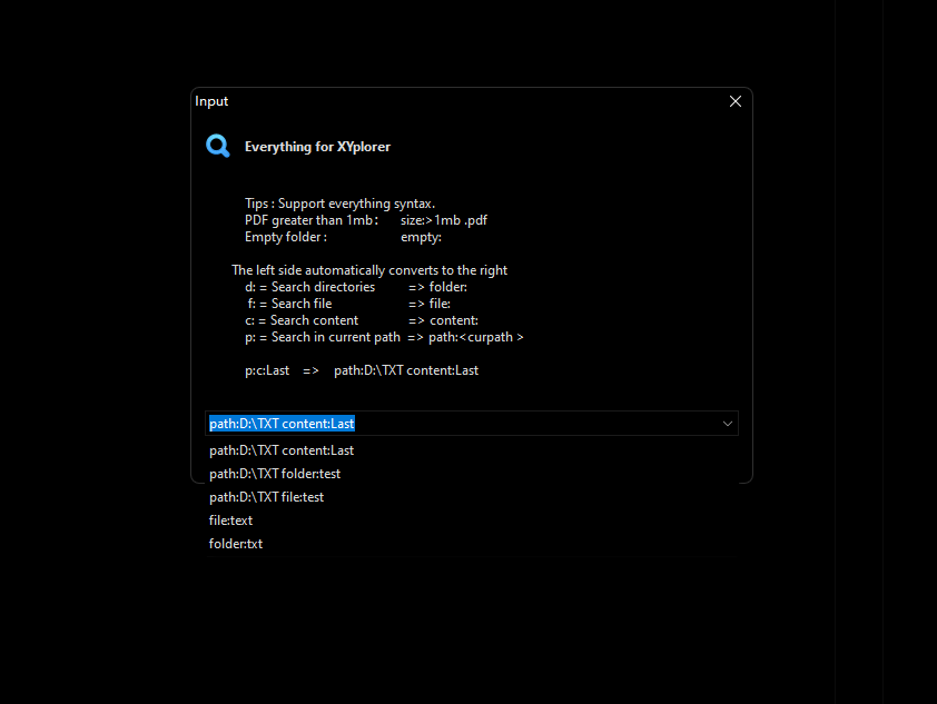

Hello everyone! This is a very simple but practical script I wrote myself,
Introduction:
This script calls Everything's command-line ES to import search results, is extremely fast, and supports Everything's syntax commands. If you don't have Everything installed, please go to the official website to download and install it.Make sure everything is started
[url https://www.voidtools.com/[/url]
installation
Drag and drop the "EV FOR XY" folder in the archive to Scripts
Run script
You can set a shortcut for this script:
Use-Manage Commands ...-Run Scripts-New
You can fill in the relative path of the script:
<xyscripts> \ EV FOR XY \ EverythingXYplorer.xys
Custom short name search
You can modify it yourself here
Examples:
size:>1mb .pdf =PDF files larger than 1MB
!c:\ size:>1mb .pdf =PDF files larger than 1MB but without C drive
dm:today =File modified today
You can also use the short name defined by the script
zip: =zip,rar,cab,7z file type
//==========================================================//good luck

Tips: abma's script use paper folder in UTF-8 or ANSI format.
Save the result to a file and open it as a paper folder (Paper folders support Unicode).
Change:
Replace & History...
goto ">cmt:$text"; //Highlight search keywords;Turn on Instant Color Filters
$delete = "!$ !@ !`% !# !\$Recycle.Bin"; //Exclude system invalid files It takes a few seconds.
Drag and drop the "EV FOR XY" folder in the archive to Scripts folder.

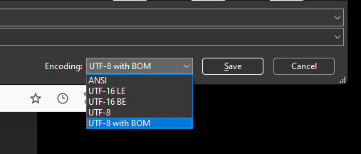

Open %temp%\EverythingForXYplorer
Open the .txt file with the same name as the paper folder
Replace "?" to "・"
Save as "UTF-8 with BOM" format to replace .txt file.
Refresh paper folder.
wf2zxp
Posts: 2
Joined: 25 Apr 2022 09:26
Re: Everything for xyplorer
Post by wf2zxp »
这种方法只是临时性的,下次搜索带间隔号的文件还会显示为问号……用论坛里的其它EVERYTING脚本倒是显示正常但会报各种奇葩的错误,用这个不报错但会发生这种显示错误,也是醉了,不知哪里的问题,可能是简中系统的问题吧……还是用回Everything本体算了 :shock:
