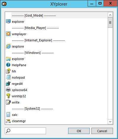

Loving the new "user defined icon" possibilities for inputselect() and finally it makes sense to use XY for launching apps...
So, here is v1.0 of "App laucher"...
On it's first start it will write an .ini file with the same base name of the script into the same folder.
It contains a few sample entries to see how it works. Uncomment them if you want them and read
the annotations in this .ini file (or in the script)!
It looks like this: Current version: Old version(s):

Hi highend, nice script. I didn't have much time to test (cruising the Baltic Sea), but I did make up a couple of new sections. I don't know what you may have planned for future updates, but it might be nice to not see the "exe" extension displayed for exec files as you have done for lnk files (e.g., Remove_Exe_Extension=1). Also, would it be possible to display the section headers minus the brackets [...] like Tools or possibly as an option to display the section header in lieu of a separator.

Hey highend, the changes are working great.
One more request or option suggestion, would it be possible to have an option to not show a icon for the section header lines. When you use a section header as a separator, you really don't need to have an icon. Not having an icon for the headers would actually make the header standout in the listings a bit more. I tried leaving Seperator_Icon=blank, but that of course didn't work.
By the way that line, Seperator_Icon=:queue is misspelled. Separator is correct in other places in the script, but it must be consistently incorrect for the icon specification since it works. That same line for Seperator_Icon= doesn't seem to work if you use a path\filename icon in lieu of XY built-in icons (the icon name is displayed with a ? icon).

@klownboy: I haven't tested this script yet, but while testing the new inputselect abilities I have found that any unused internal button names like :whatever, display a blank icon instead of a
when an icon resource isn't located, so in theory Seperator_Icon=:blank should work.

Yes, you are right Jupe, that works fine. Thanks. Looking back, I shouldn't have written my post above as "Seperator_Icon=blank" as not working. What I meant was "Seperator_Icon=" I know there's also a blank.ico around that's used on some utilities to hide the shortcut arrow on lnks. I have it on my desktop computer at home. Thanks again.
Too bad the inputselect box couldn't be cleaned up a little by removing the numbering on the left side as an option. In many cases the numbers just aren't necessary in the display.

v0.4 is online
Changelog
Let me rephrase this:
Existing .ini files need a manual replacement of "Seperator_Icon=" with "Separator_Icon="!
Changelog
v0.4
! Fixed a bug regarding the wrong spelling of "separator"
! Fixed a regex bug reguarding the building of the "Caption|Data|Icon" stuff
* Changed the default value of "Separator_Icon=" to ":blank" which will lead
to an empty icon
