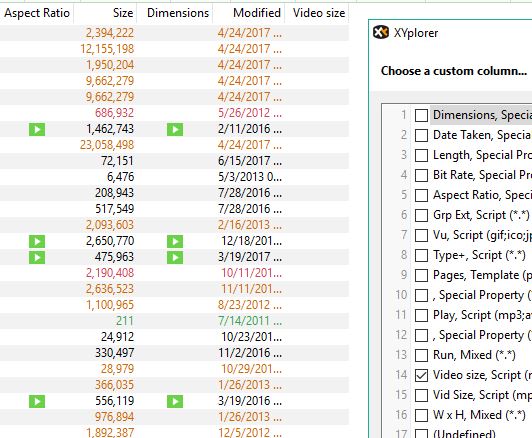

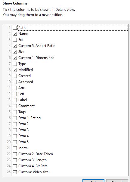

Sorry highend, I didn't realize it was suppose to be reflecting existing CCs already. Originally when I ran it it reflected no checked boxes. When I just ran it again it only reflected the one box that I added on my original run (Video size) as you can see in the capture. Examples: Dimension and Aspect Ratio are simply using Special Property | Dimensions and Aspect Ratio respectively. Both are: Format:Mixed, Trigger: Click, Item type: Files, Item filter: jpg;jpeg;png;gif;psd;psb;ico

Show me the snippet of both of these columns please and (for one of them) a screenshot of how it is configured
(I need to see all checkmarks inside the "Columns:" listview part in the config window for it)
Additionally please tell me if it works when you activate the cc number 12 with this script.
Is the cc checked on the next run and does it vanish when you deselect it?

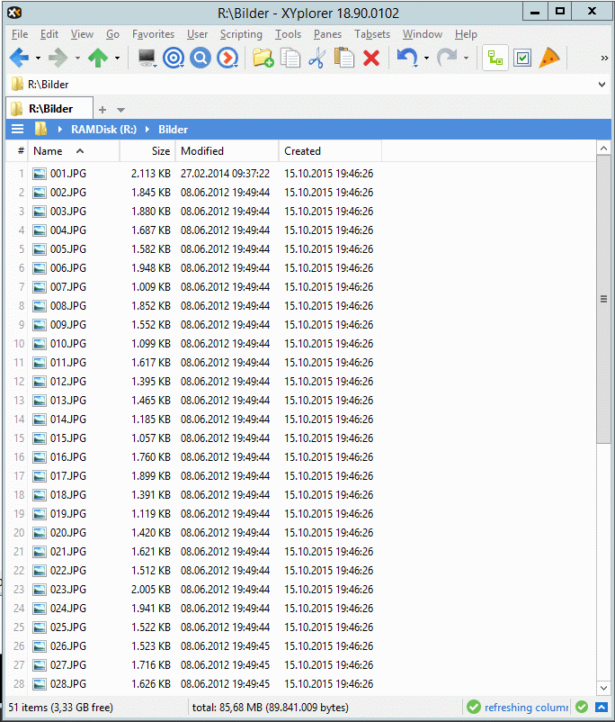

Hi Ken,
this is an animation of how the script behaves with your custom column setup
(sorry, forgot to capture the mouse cursor but I hope it's visible what I'm doing here):
Can't see anything wrong here...

I don't know what caused the original problem for me even after doing a fresh, but I forgot to mention that I have a bunch of column layouts and one for the Downloads folder layout that I was using with your script. After reloading the column layout, applying some modifications to my columns, the check marks in the dialog box are all appearing as they should be reflecting all existing custom columns. I have another column layout I'll apply to my MP3 folder and report back later.
