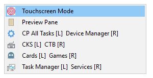

One most obvious example for its use in an XY menu script is being able to execute the normal action of an XYplorer built-in toolbar button with the left mouse button and the button's context menu with the right mouse button - as seen for menu item Touchscreen Mode and Preview Pane below. Similarly, you can also execute left and right mouse actions of your Customized Toolbar Buttons. You could assign totally different actions to the left & right mouse buttons. You should be able to cut down the size of some menus by being able to provide left and right actions. Most importantly, I notice no lag once-so-ever, the right click mouse actions execute as fast as the left. See the example XYplorer menu below.

Screen shot of the sample XYplorer menu.

Nice work getting this to work, one thing I found out recently that you may already know about but I found useful is that if you put a <tab> in the caption it right aligns the second part of the caption which might be desirable in this use case.
eg.
"Control Panel [L]<tab>Device Manager [R]|:conf"
"CKS [L]<tab>CTB [R]|:cks"
"Cards [L]<tab>Games [R]|:ghost"
Here's a screenshot (hopefully it shows up this time)

jupe wrote:one thing I found out recently that you may already know about but I found useful is that if you put a <tab> in the caption it right aligns the second part of the caption which might be desirable in this use case.
Actually no, I didn't know that. I experimented a bit inserting tabs via my text editor, but I didn't try inserting a tab character <tab>. When setting up the menu with right click action right-aligned, I'm not sure if it's even necessary to have the [L] and [R] abbreviations. Or another thought, it seems to look a bit neater if you place the [L] symbol on the outer left edge. So the [L]'s are all on the outer left, and the [R]'s are on the outer right side. Thank you for the tip and comment. Now if we could only get an icon for the right side action. :)

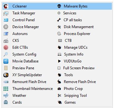

I'm still thinking about alignment, but I can't achieve what I want exactly. I was hoping someone could help me. Maybe it's not the right place to ask, but since the background is here I'll start here. Is there any way to get an alignment like 2 columns both left aligned in an XYplorer menu similar to what I have below. I had to use spaces to get approximately alignment. When you insert a tab in the text editor or a tab character, <tab>, you get right-side alignment as jupe screen capture depicts above.
Thanks for any help.

Posts: 15016
Re: Right Mouse Click functions in XYplorer menus
Probably not possible without changing the way (through Don) how such
a menu is displayed. It's not a monospace font in the menu so trying to
align right hand side items on it's leftmost position will never be accurate...
Posts: 4477
Oh well, thanks highend. I figured I'd ask but I really didn't think it would be possible. I know you can build that kind of alignment in a text box using a combination of SC Substr and StrRepeat, but a text box and a menu are two different things. It's too bad you can't tab in the text editor to achieve column type alignment like you typically can - instead of right-hand alignment. So normal tabbing in the text editor would be displayed in XYplorer as a normal tab whereas the tab character, <tab> would achieve right-hand alignment. Does that make sense or would it make sense to ask Don?
Posts: 15016
I would ask Don what's possible inside the menu. Subclassing it would probably
a way but that's most of the time a can of worms so I don't know if he wants
to invest any time on improving it...
