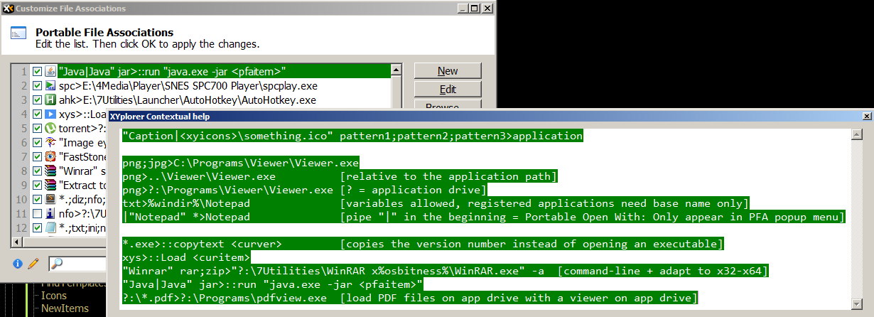

While waiting for the wish here http://www.xyplorer.com/xyfc/viewtopic. ... 54#p106154
I make a preview.
Usage:
1) Open the .ahk file with Autohotkey.exe (version 1.1: http://ahkscript.org/download/) OR comply that .ahk file to .exe using http://ahkscript.org/download/ahk2exe.zip
2) While Batch rename/PFA/QNS/VF dialog is active, Press F1 will trigger the relevant "XYplorer contextual help".
3) You can edit the help text in the "XYplorer contextual help" window,
4) X-Close/escape that window will auto save changes. Right-click the edge of window (except Title bar) will close without save changes
(*) There're some tidbit grace:
- The help window will not overlap VF/QNS... dialog.
- Close the VF/QNS... dialog will close the help window too (without saving chages to help file)
(*) Customize the .ahk file:
- Don't want the icon in tray? Uncomment the 2nd line (#notrayicon)
- Want a borderless help window? Change from "+Caption" to "-Caption"
As a preview, it's raw until Don implement the above wish, so vote for me!
XY_Contextual_help.zip
v0.5
(4.66 KiB) Downloaded 252 times

btw, my PFA.txt now look like this:
"Caption|<xyicons>\something.ico" pattern1;pattern2;pattern3>application
png;jpg>C:\Programs\Viewer\Viewer.exe
png>..\Viewer\Viewer.exe          [relative to the application path]
png>?:\Programs\Viewer\Viewer.exe [? = application drive]
txt>%windir%\Notepad.exe          [variables allowed]
readme.txt>notepad                [registered applications need base name only]
|"Notepad" *>Notepad              [pipe "|" in the beginning = Portable Open With: Only appear in PFA popup menu]
*.exe>::copytext <curver>         [copies the version number of a dbl-clicked executable]
xys>::Load <curitem>
"Winrar" rar;zip>"?:\7Utilities\WinRAR x%osbitness%\WinRAR.exe" -a  [command-line + adapt to x32-x64]
"Java|Java" jar>::run "java.exe -jar <pfaitem>"
?:\*.pdf>?:\Programs\pdfview.exe  [load PDF files on app drive with a viewer on app drive]
