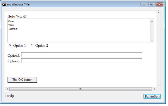

Add some HTML code to add some functionality:
Awaited result (resized):
Work up the result:
Execute the script and enter some data and/or chose one or another option. Then...
$TextAreaDefault = "One<crlf>Two<crlf>Three";
$myXYVariable = html('<HTML><FORM method="GET" action="xys:">
Hello World!<BR>
<TEXTAREA name="BigTextArea" rows=6 cols=75>' . $TextAreaDefault . '</TEXTAREA><BR>
<INPUT type="radio" name="myOption" value="Option1" checked> Option 1
<INPUT type="radio" name="myOption" value="Option2" > Option 2 <BR> <BR>
Option5: <input type="text" name="Option5" size="80" Value=""> <BR>
Option6: <input type="text" name="Option6" size="80" Value=""> <BR>
<BR><BR><BR>
<INPUT type="submit" name="Submit" value="The OK button">
</FORM></HTML>', "700", "630", "my Windows Title");

URL Links
To use URL links in your HTML page use the xys advice like:
<a href="xys: myURLone">Execute One</a>
The follow up code to proceed with this is something like:
// IF an link is clicked
IF ($myXYVariable == "myURLone") {
msg "Link One was pressed";
For example:
<HTML>
Hello World!<BR>
</FORM>
</HTML>
// IF the [Close]-button is pressed instead of the [Submit]-button:
IF ($myXYVariable==""){
msg "cancel pressed";
END 1==1; //quit whole script
// do some work....
} else {
//split the result into parts (see above)
// do some work....
