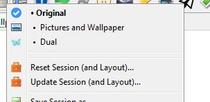

Re: Session Manager [v4.5 ML(5)]
Hi Flux,
thank you very much for this very nice Xmas feature update! :D
Due to xmas I could just did a quick test.
Modifier support seems to be ok.
Icon support: assigment works. However, after the first icon has been assigned the standard icons (SM_menu_before_icons.png) for unmodified entries are gone and all entries get "bulleted", which doesn't look that good. :wink:
:appl:
/e: updated screenshots

@Filehero
Filehero wrote:However, after the first icon has been assigned, the standard icons (…) for unmodified entries are gone and all entries get "bulleted"
On purpose…
When one starts using dedicated icons to identify specific sessions, the default "layout" icon which identifies all layout sessions has to be removed, else no icon pops-up and everything feels cluttered.
So I tried a few things and adding the bullet to identify layout sessions seemed the less intrusive —though I understand your case where all your sessions are layout sessions! ;)
Hence all your sessions are bulletted, which looks cluttered too...
I must admit I didn’t see it coming: only about ¼ of my 15+ sessions are layout sessions.
Now, I just made a try with the tiny "space mark" "·" bullet instead, which may be better after all, looks quite good here.
Replace the following two entries (one with the bullet, and the other with a non-breaking space to keep alignment of sessions indentation). Try it and tell me what you think.
$GEN_Lay_Prefix = "• ";
$GEN_Lay_Prefix = "· ";
$GEN_Lay_Prefix : " $GEN_Lay_Prefix ";

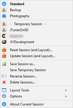

Posts: 2721
Hi Flux,
when I do this
$GEN_Lay_Prefix = ""; // line 168
and
$d_Lay_Prefix = $GEN_Lay_Prefix; // line 303
I get this
which is already quite what I like to have.
Finally I took this icon, removed the vertical line on the bottom right and modified the ini to get this
Modified icon:
S_2.zip
(83.85 KiB) Downloaded 264 times
Maybe we could "simply define" an optional own default icon which is then globally used until overwritten per session?
Anyway, SM-Manager my day-safer script. :beer:

• Most notable fix concerns Autosave when active and used with regular tabsets (instead of sessions), which created a blank session.
 — Improbable that anyone was affected by that, except if you made some tests (fresh installs…). In that case, you can check your <xypanes> folder and delete the following folders if they exist: "§1§_         •• Autosave ••" and "§2§_         •• Autosave ••".
• A small bullet "·" is now used instead of the big "•" to distinguish layout sessions from regular sessions when using icons.
@Ken and Filehero and those with layout sessions only
I hear you!
Let’s start with this: now, no bullets at all are displayed if all sessions are layout sessions.
@Ken
I can’t reproduce the double separator issue… :eh:
FYI, it doesn’t show but the whole separator thing gave me a lot of work already, because they’re auto-added or removed depending on the position of the session list (top or bottom), Temporary session or not, Ordered vs unordered sessions, and quick sessions!
So I thought I had tried and checked all combinations… but still now while trying on a fresh install to mimic your screenshot, I only have a single separator.
So same question as with Enternal (which also displays a double-separator issue): what is your XYplorer version?
Klownboy wrote:(the second line I assume is where the temporary sessions go as seen in Filehero's caption)
Nice try… ;)
But in his case, the separator differentiates first the list of sessions he has ordered, from the rest of the (unordered) sessions. And his temporary session isn’t a "real" one (he probably renamed it at some point), if it was it would be listed separately at the bottom of the whole list of all sessions! 8)
Posts: 4407
Re: Session Manager [v4.51 ML(5)]
Hey Flux, I was just taking a stab at what the double line issue could be. All I can say is I'm using the latest XY beta 16.10.0200. I'm using no temporary sessions and have not used this feature in the past. I have re-ordered the list at one time, but that's all there is - those 3 sessions shown in the capture. When I get back home I can more thoroughly test on my desktop. I did load SM v4.51 and see the dots are gone when all sessions have layouts though I think I like the look a bit better with no change in indentation. Double lines are still present. This laptop I'm using is Windows 7 x64. Thanks.
