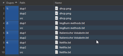

Using a modified version (only with a slightly enhanced output):
which 100% matches this search result:
REM Group: 1 => 2 dupe(s)
DEL /F /Q "T:\!tmp\dup2\dhcp.png"
mklink /H "T:\!tmp\dup2\dhcp.png" "T:\!tmp\dup1\dhcp.png"
DEL /F /Q "T:\!tmp\src\dhcp.png"
mklink /H "T:\!tmp\src\dhcp.png" "T:\!tmp\dup1\dhcp.png"
REM Group: 2 => 4 dupe(s)
DEL /F /Q "T:\!tmp\dup3\ImgBurn methods.txt"
mklink /H "T:\!tmp\dup3\ImgBurn methods.txt" "T:\!tmp\dup1\ImgBurn methods.txt"
DEL /F /Q "T:\!tmp\dup4\ImgBurn methods.txt"
mklink /H "T:\!tmp\dup4\ImgBurn methods.txt" "T:\!tmp\dup1\ImgBurn methods.txt"
DEL /F /Q "T:\!tmp\dup5\ImgBurn methods.txt"
mklink /H "T:\!tmp\dup5\ImgBurn methods.txt" "T:\!tmp\dup1\ImgBurn methods.txt"
DEL /F /Q "T:\!tmp\src\ImgBurn methods.txt"
mklink /H "T:\!tmp\src\ImgBurn methods.txt" "T:\!tmp\dup1\ImgBurn methods.txt"
REM Group: 3 => 1 dupe(s)
DEL /F /Q "T:\!tmp\dup2\Italienische Vokabeln.txt"
mklink /H "T:\!tmp\dup2\Italienische Vokabeln.txt" "T:\!tmp\dup1\Italienische Vokabeln.txt"
REM Group: 4 => 2 dupe(s)
DEL /F /Q "T:\!tmp\dup2\Netflix.txt"
mklink /H "T:\!tmp\dup2\Netflix.txt" "T:\!tmp\dup1\Netflix.txt"
DEL /F /Q "T:\!tmp\src\Netflix.txt"
mklink /H "T:\!tmp\src\Netflix.txt" "T:\!tmp\dup1\Netflix.txt"
